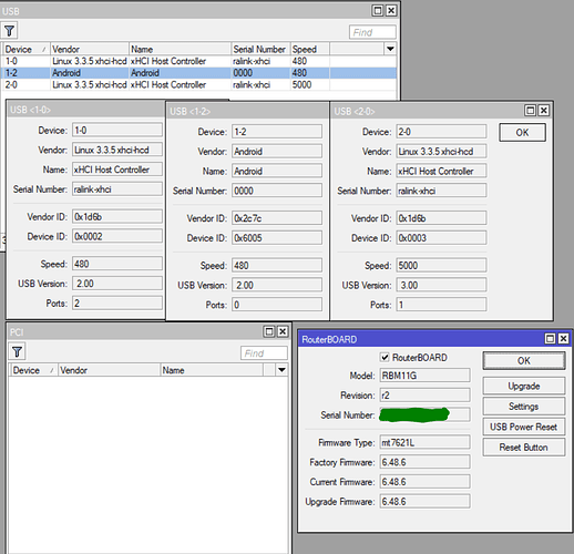

I bought LTE Cat4 module Quectel EC200A-EU and conenct it to my mikrotik RBM11G.
Over winox this mpcie card shows as "Android" device.
How to connect correctly this card? I have tryed tape USB3.0 pins but also there is same result

PS. attached screenshot of of stuff from winbox

UPDATE:
firstly updated to 6.49 -> it doesn't help
then updated to ROSv7 and it works perfectly
