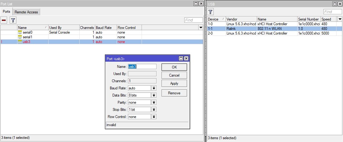

Hello. Can MT work with wifi module connected to usb port?
I tried to connect the one that I have available. He was seen in yusb devices, correctly identified his model (Ralink). It also showed up in the port lists. But here it is red. And if you click on it, then in the details window it says that it is invalid.
No. Мikrotik stopped supporting the usb wifi adapter with the 6th version of ROS . Also only atheros based adapters were supported!

a USB-Wifi adaptor is not necessary a serial (UART) adaptor, like the Woobm.
Woobm does work as serial/console adaptor via wifi.
The checked port list in Winbox screenshot is for serial connections over USB. Converting between USB and serial TTL/RS232/FTDI console connection.
Woobm gives wifi access to that serial port.
A USB-wifi adaptor gives a wifi connection via USB. (like USB thetering with a smartphone). Often called wifi-stick or wifi-dongle
No idea if ROS supports this, but if it does it should appear as a (wireless) interface. Not expected to happen
