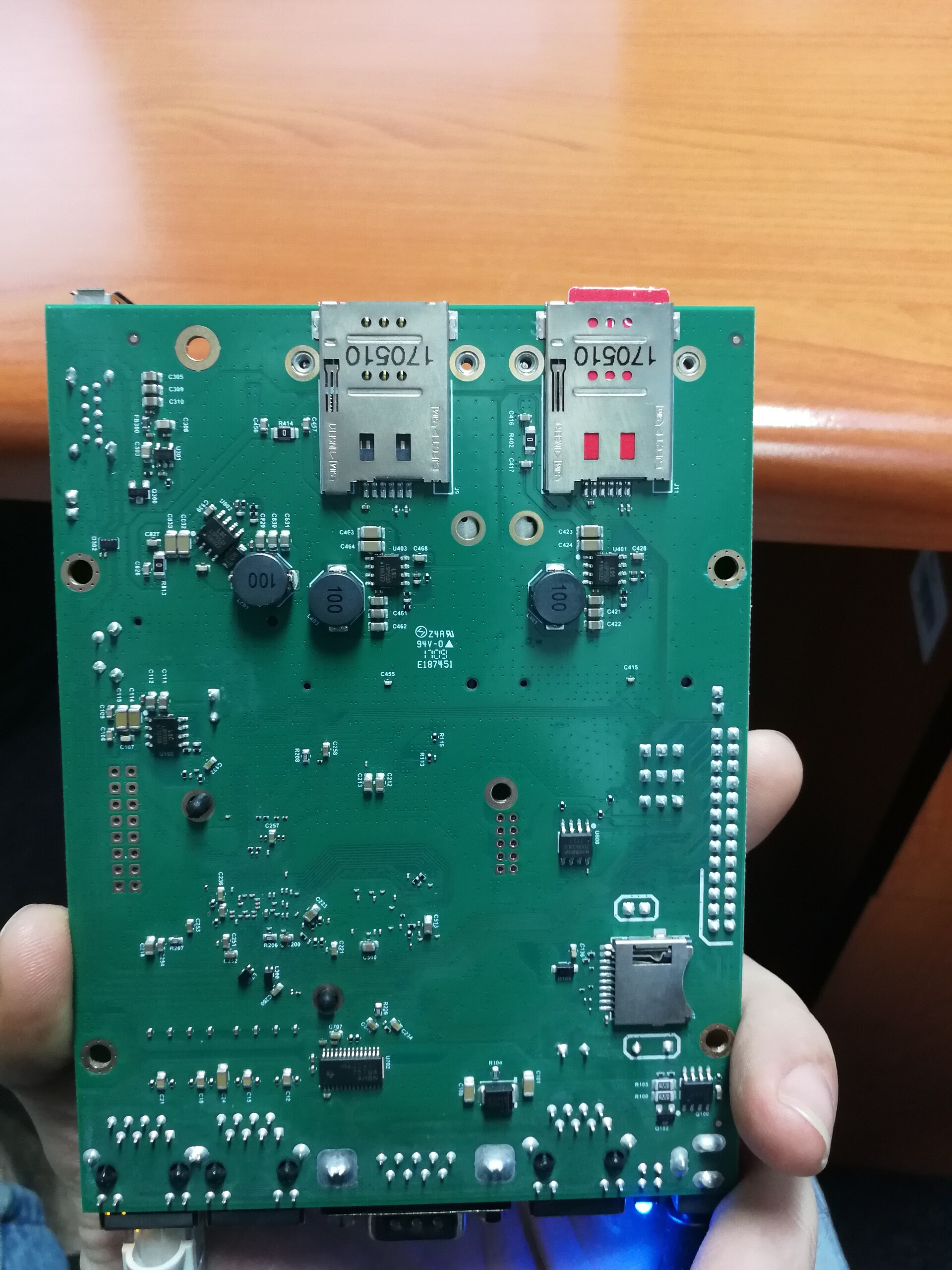

I purchased a few RBM33G units with additional LTE Modules.

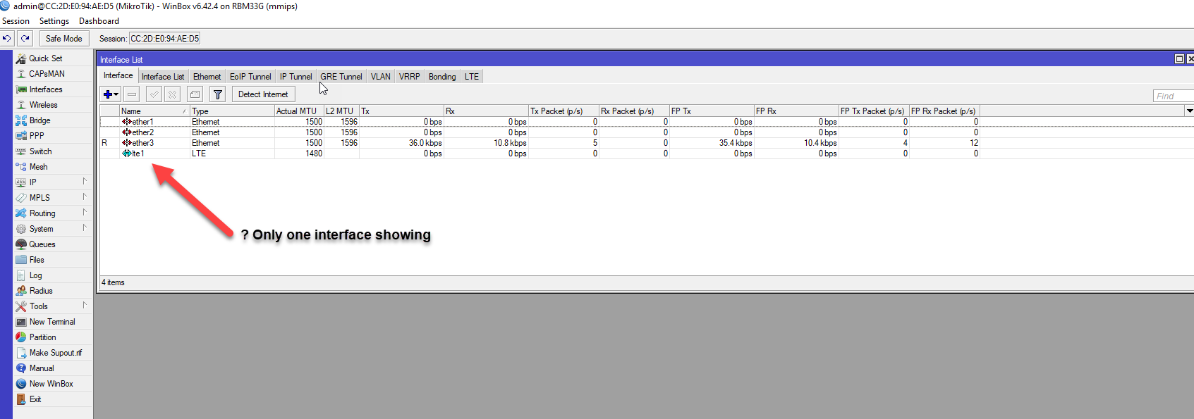

My issue is, that when I connect both LTE modules onto the board, I only see one LTE interface come up?
How do I use Both LTE Modules?
The unit has 2 Sim Slots and 2 Expansion slots?
I have tested all 3 boards and still the same outcome?

USB jumper. Located right next to the USB 3.0 port. When loaded, the jumper enables the USB 3.0 port. Remove the jumper to switch the USB 2.0 lines to the J10 (central) miniPCIe slot (USB 3.0 lines remain enabled to the USB port). > This is required if lou need to use two cellular modems > in the device.

Removed the jumper now and its working and showing both interfaces :slight_smile:
