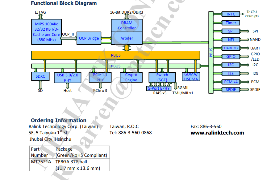

Check a block diagram, both mPCIe slots use USB 2.0 bus then it’s limited to 480Mbps.

  • From the block diagram it seems that an mPCIe port is connected directly to the mediatek SoC.

Block Diagram not show us for RBM11G info what limitation have a mPCIe slot at this unit. Maybe like USB3.0 or USB2.0 - you have it and can check this !.
I not have M11G or M33G and I base at forum answers and documentation.
I have only rbm11g not yet have the modem, I was asking if you could understand from the data sheets or with some specific test

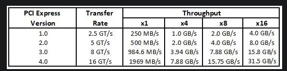

these are some information i found, and since the mPCIe is type 1.1 the bandwidth should be about 250 MBps, do you have any confirmation?
Block Diagram not give us confirmation, I write you that.
At CPU Spec https://www.mediatek.com/products/homenetworking/mt7621 are info like
  • PCI-Express: Host(3)
  • USB: USB 3.0 (1), USB 2.0 (1)
but still we not know what is at usb3.0 connected or where mPCIe is connected.
