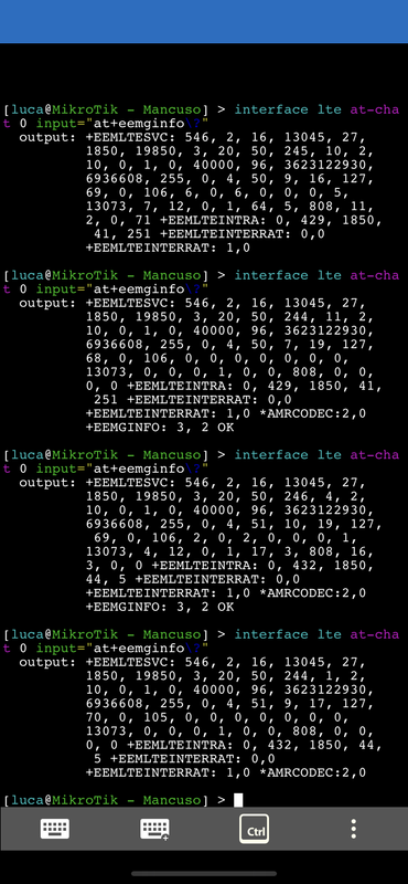

  • I attach you other data collected from iPhone with the same Cell but I think that the main problem is the antenna that I used…

How read result of your screenshot: https://www.philmug.ph/community/threads/how-to-check-the-active-lte-band-and-carrier-aggregation-status.98720/
My opinion is: iphone connect 2xB3, means 2CA B3+B3.
rsrp0 primary-band = -89
rsrp1 ca-band = -95
sinr=18,5
All this means very good cqi
but
dl_bw=B3@10MHz, not at max @20Mhz means you not receive top max value. I am not i$Phone expert and maybe this =100 is not 10Mhz..
At iPhone XS bests iPhone XR in cellular signal strength thanks to better antennas article you can see the perfect situation with mimo 2x2 and without CA (Means one Band 4 is like Band 1 at 2100Mhz..) Graf:
But... of course your iPhone have 10Mhz width, but with 2xCA....
But you not receive that theoretical >150Mbs... maybe your BTS is limited with some policy like FAP (Fair access policy) / FUP (Fair Usage Policy) etc. or maybe his uplink have other limits.

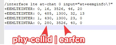

This is my BTS info (run multiple time)
How to read results via column

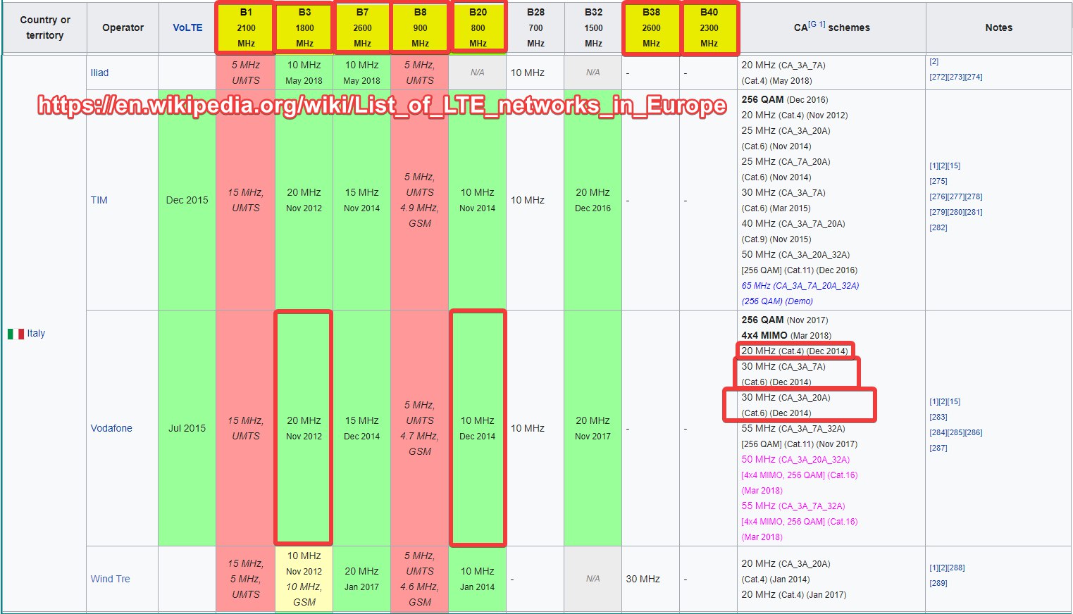

Italy LTE Band-s and Your ISP
