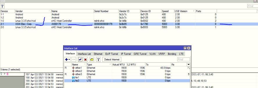

I am trying to add a (USB3) usb to lan adpator on my RBM33G routerboard ( v6.48.2). It is visible in resources but not in the interface list .
I am also using two Lte (USB2) modem which are working fine and visible in the interface list .I have removed the jumper to enable two minipci USB 2 ports and one USB3 .
As per the document .Removing the jumper enables the use of a secondary cellular modem in the central J10 slot, but disables the USB 2.0 functionality of the USB port, while USB 3.0 can still be used on the USB port.

I have a similar problem. I tried to use Woobm-USB + 2x LTE interfaces without success.
Regards.
