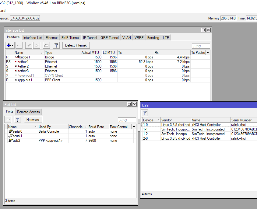

I have is RBM33G and 2 lte modem SIM7100E minipcie.

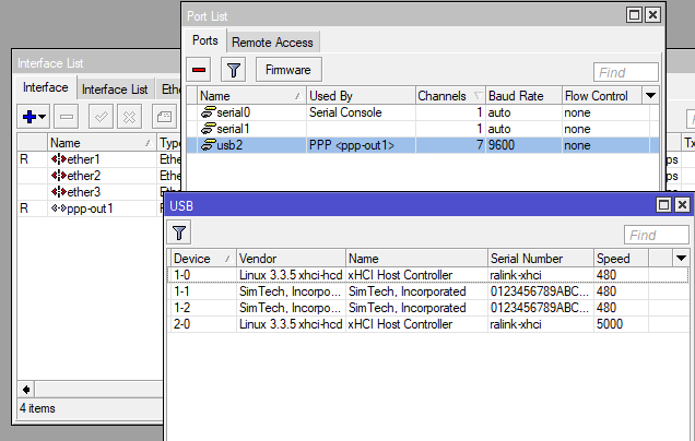

Both modems are determined by the system in system-> resources-> usb under the numbers 1-1 and 1-2.
The connection on this modem is supported by PPP, it is created by default, but only one on the modem 1-1, when trying to create a PPP connection manually for the second modem, an error appears that the port is busy. In system-> port one usb.
How to make two modems work?

I think the bug in routeros, both modems are defined, but only one works.
But in Port List you have only one USB device detected and this mean you cannot create a new PPP connection on next usb port - it don’t exist.

ROS version 6.46.1. I swapped modems, included only one modem on different ports - only one modem works at a time, both do not work.
