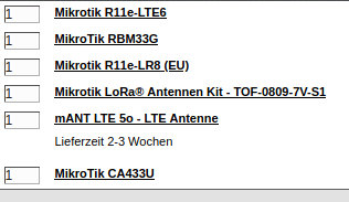

Will this work, see Screenshot attached.
What confusing me are the possible LTE/4G cards, which one will work for O2 LTE Germany ?
Did a need a LTE Antenna ? Is the mANT LTE the right one ?
Marcus
What I’m missing in your shopping list are
  • two cables (pigtails) U.FL to SMA (ACSMAUFL), to “convert” the U.FL connector on the R11e-LTE6 board into a SMA female peeking out from the CA433U case,
  • two SMA male-SMA male cables (SMASMA) to connect the LTE antenna (they are not bundled with the mANT LTE 5o)
  • probably one more U.FL to SMA (ACSMAUFL) to do the same for the LoRa signal, as the LoRa antenna set also comes with an SMA male-SMA male cable (this time it is bundled)
  • power supply (which you may already have though)
As for “will it work with O2 Germany”, check the channel usage here and compare it to the product description.
