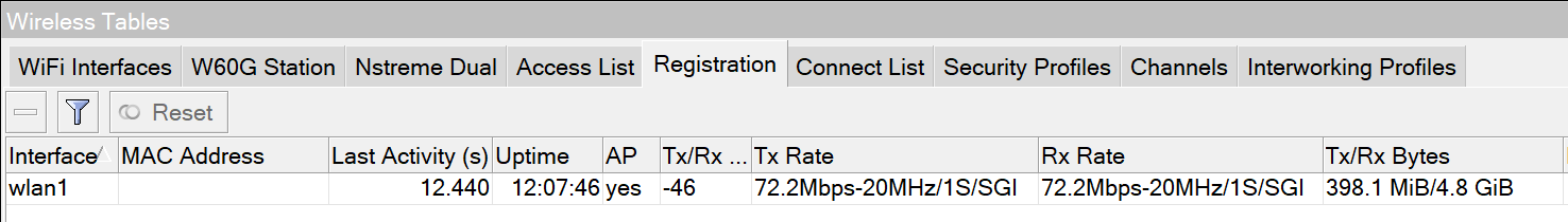

Under load, the link will average 150 to a maximum of 265Mbps UL or DL. CPU runs between 7% and 72%, temperature is nominal 34C - 38C.
Link power is nominal (between -61dBm and -54dBm) and I see no indication of DFS issues on the CPE side (there are detailed logs).

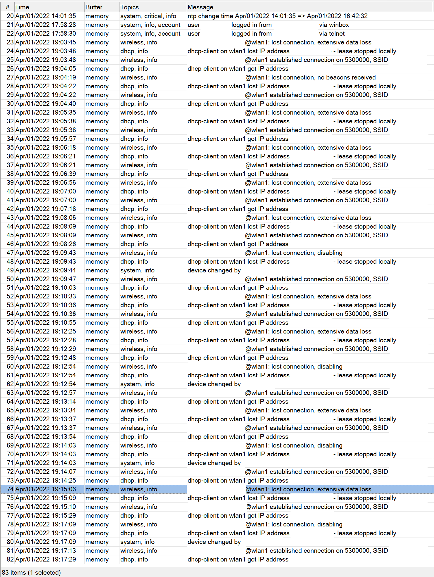

Network connectivity and reachability when initially established works as configured, no firewall issues.
Under constant or random load of 10Mbps to 100 Mbps UL+DL, the wireless link will disconnect repeatedly and erratically. There is no predictable pattern to this.
The reasons are most commonly extensive data loss and less commonly no beacons received.

Update April-02: Stable function on 2.4GHz with no disconnects since I switched it over.
Seems to be just 5GHz that has this issue.
Update 2-April 02: Very stable on 2.4GHz since, but at the loss of so much link throughput since I can’t get the CPE to use 40MHz due to crowding.
Update 3-April 03: Tried load testing at 15Mbps UL+DL again and the 2.4GHz link crapped out and stopped responding to traffic, requiring me to disable/enable the link to get it functional again. It didn’t drop its DHCP lease or disconnect from the network, it just stopped delivering packets via the default route and was still reachable via Winbox. This is worse than I expected.
Update 4-April 04: The same problem as update 3 continues. The 2.4GHz link to the CPE appears connected with no issues, wireless link rates indicate connectivity hasn’t dropped so it doesn’t appear that the wireless driver is faulting (although who really knows what is going on because I can’t see the kernel logs) and then suddenly, without warning, the Metal stops delivering packets to the default route. Pinging Cloudflare DNS returns “unreachable from ”. Disabling and re-enabling the link restores connectivity but this really shouldn’t be the case. I can script restarts of the link but is that really what it has come to? Still waiting on support response (I’m reasonable, I’ll give them at least 30 days since I’m not some major corporate customer or anything like that). I should note that the above scenario is occurring randomly, without link load or with link load. There is still no predictable pattern to the issues. CPE WAN and LAN uptime is 25+ days with all directly connected clients logging 6 to 12+ days uptime and no stability issues. I’m going mad.
