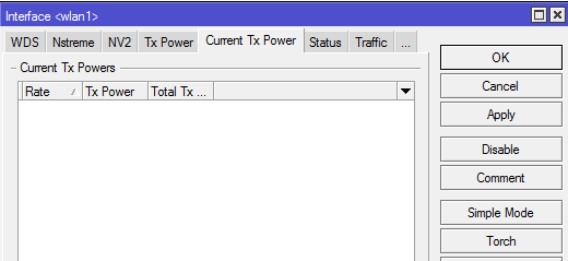

Hi all, please I can´t set tx-power less then 17dB. RBMetalG-52SHPacn, 6.35.4 (firmware 3.31). Any tips please? Thanks
>interface wireless set wlan1 tx-power-mode=all-rates-fixed
>interface wireless set wlan1 tx-power=10
>interface wireless manual-tx-power-table p
0 name="wlan1" manual-tx-powers=1Mbps:17,2Mbps:17,5.5Mbps:17,11Mbps:17,6Mbps:17,
                 9Mbps:17,12Mbps:17,18Mbps:17,24Mbps:17,36Mbps:17,48Mbps:17,
                 54Mbps:17,HT20-0:17,HT20-1:17,HT20-2:17,HT20-3:17,HT20-4:17,
                 HT20-5:17,HT20-6:17,HT20-7:17,HT40-0:17,HT40-1:17,HT40-2:17,
                 HT40-3:17,HT40-4:17,HT40-5:17,HT40-6:17,HT40-7:17
In Winbox is "Current Tx Power tab empty.

The /interface wireless manual-tx-power-table menu does not show the current (effective) tx power. This menu is where you can manually set tx power for each rate separately; these settings are only effective when tx-power-mode is set to manual-table. Please consult this manual page for more details.
Viewing current TX power is not currently supported for AC boards. This is a known issue.
Thank you for replay. I understand now.
If I will use tx-power-mode=all-rates-fixed rates-fixed are respected?
Yep.
