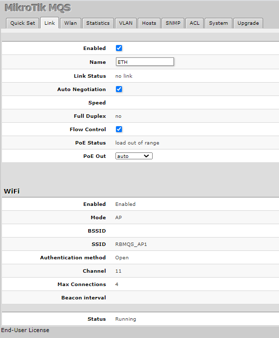

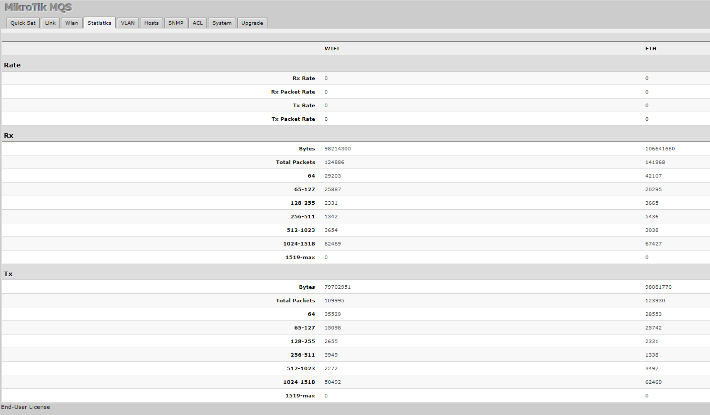

I need some advice regarding the MQS device - We are getting very very bad throughput while doing diagnostics and speed tests - I know the unit has a tiny processor, and I’m not expecting 100mbps throughput, but not even getting 10mbps - surely something isn’t right?
Changing bands, frequencies and protocols doesn’t help at all. Also disabled SNMP, DHCP, etc in case it was taxing the tiny CPU.

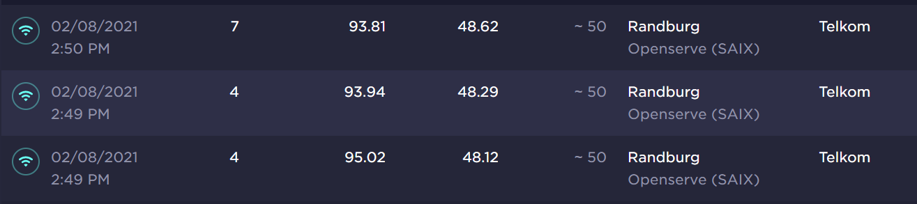

Line Actual Speed:

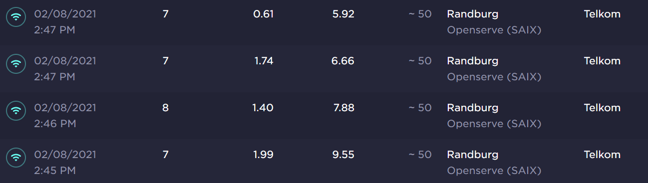

Speed test through MQS connected from WAN ETH to WLAN:

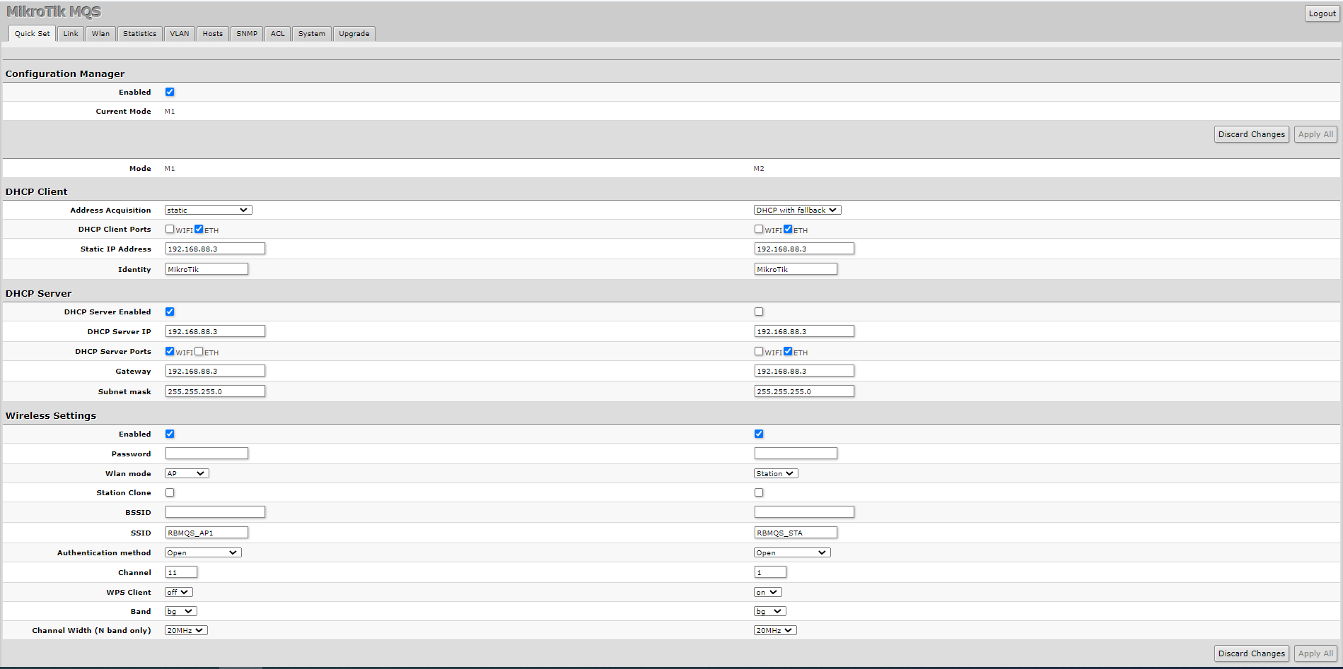

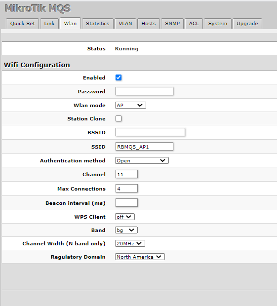

Config Pages:

MQS’s main purpose is to manage other devices and to do their maintenance if needed. High throughput should not be expected, but in your case, I recommend try changing the band from b/g to b/g/n.
