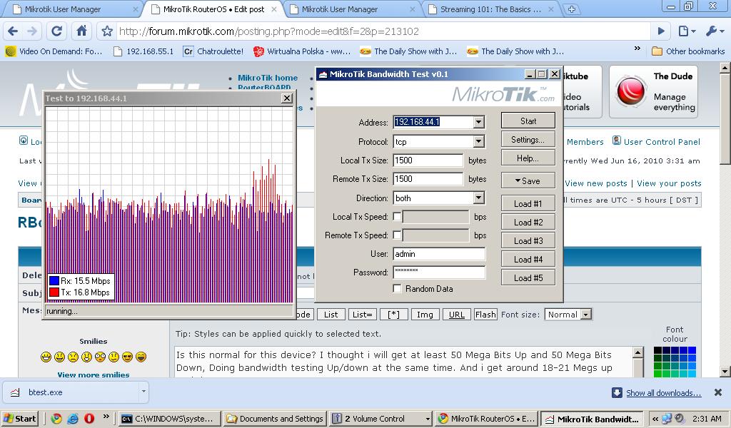

Is this normal for this device? I thought i will get at least 50 Mega Bits Up and 50 Mega Bits Down, Doing bandwidth testing Up/down at the same time. And i get around 18-21 Megs up and down.
I am cable connected to Eathernet port 4 on the RBoard,

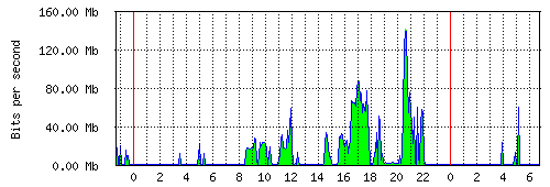

you mean, 6-8 Mbps? what is CPU load of RB? I have just installed RB450G, it’s doing NAT (netmap), a bit of IPIP tunnels… and routes upto 200 Mbps
by the way, that’s it =)

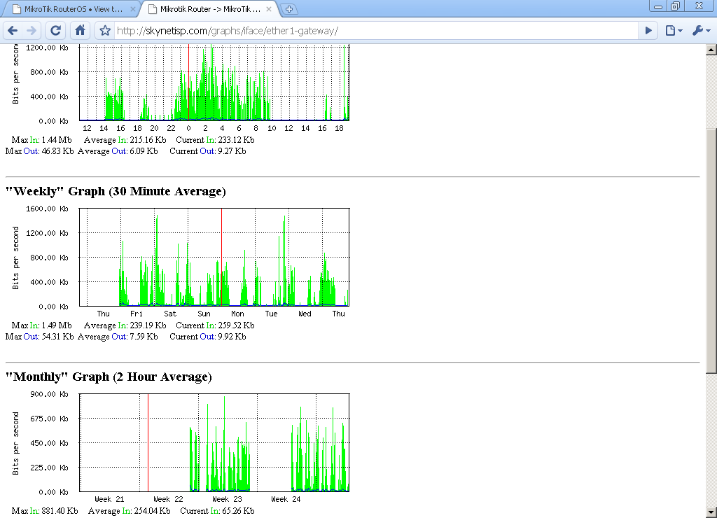

huh… look at the daily graphs =)
ether1:
CPU:
my is only around 1mb

btest 0.1 seems to have a bug:
Win7 w/btest --[udp 1500]-- Win XP w/btest maxes out 17-24Mbps, one way (just tested it)
That might explain poor test results.

btest between two computers, one running Windows7 and second running Windows XP will not go above 17-24Mbps for whatever reason. This means that btest is not a good program to test throughput with.

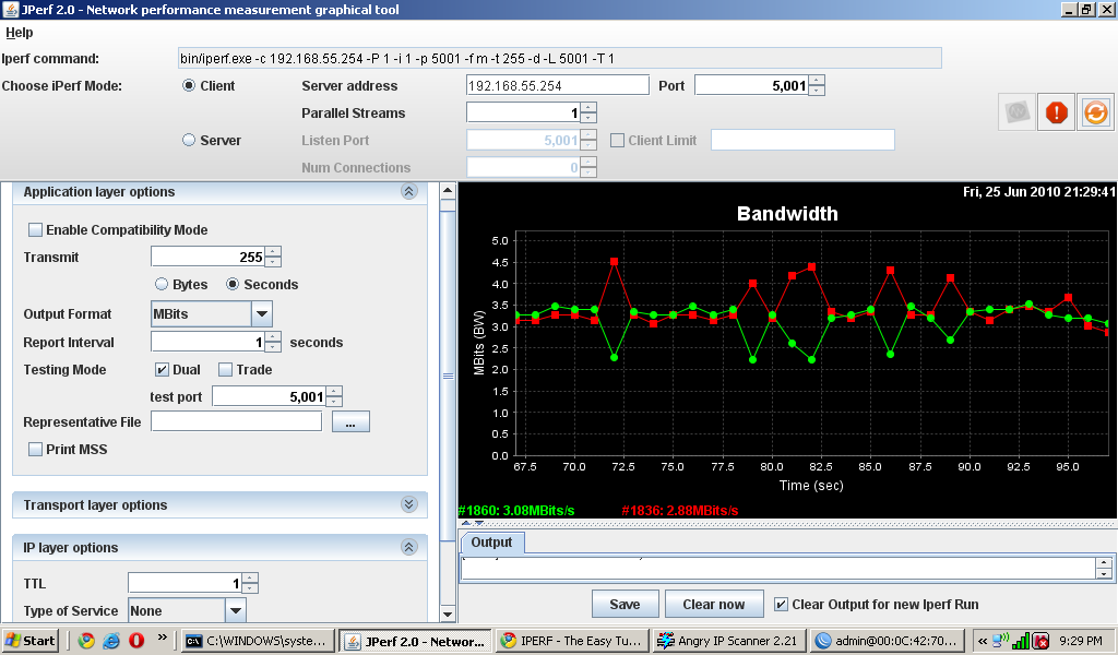

Hi
  1. First Download Scenerio
    I tested with iperf with 2 PC runing winXP LAN IP/SUBNET 192.166.0.0/24
Note ( DLink AP N B G mode for Client NICs "network interface cards "
2. Second Download Scenerio

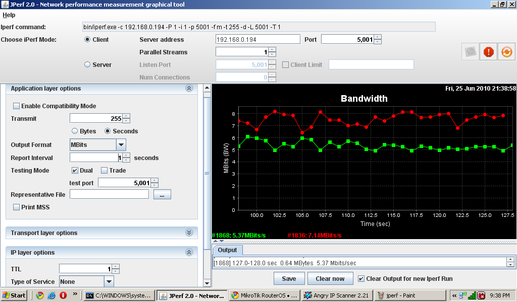

I tested with iperf with 2 PC runing winXP LAN IP/SUBNET 192.168.55.0/24
NOTE:
I user Asus AP bridged with MT Router Board 750g. Everything disable on the Asus AP except Antennas. I have hot spot disable only default firewall rules are enabled. That is it.
Still the same results in the range of the first test? Is it because i have B mode so it cuts down to so low in up/down, or maybe windows PCs causing it?
What do you think?
P.S will test 2 PC now conected by cable directly to MT ethernet ports. See what is going to happen then.
