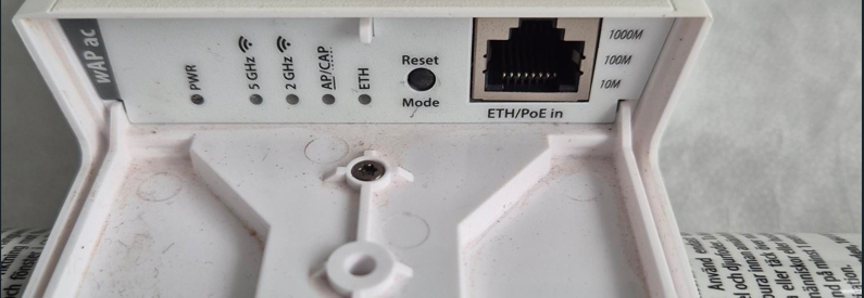

Here is a picture of the wAP
Test the devices with short cable (between injector and wAP ac) to exclude cables from being problematic.
