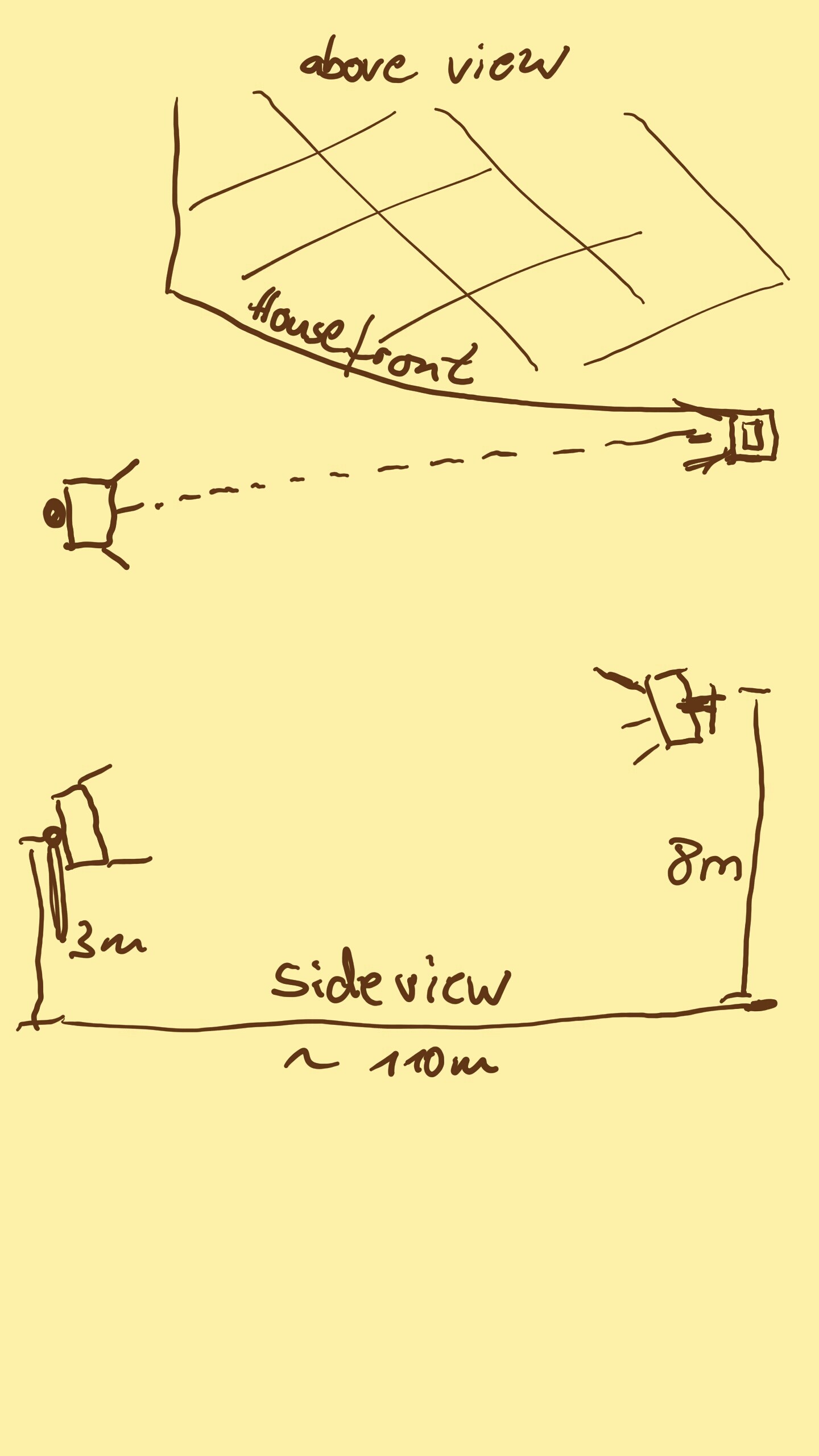

See attached rough topology..

Reflection can be on the item mounted next to the window. This has at the moment no metal casing so I assume a wider range of transmission. May there is a reflection from house front.
