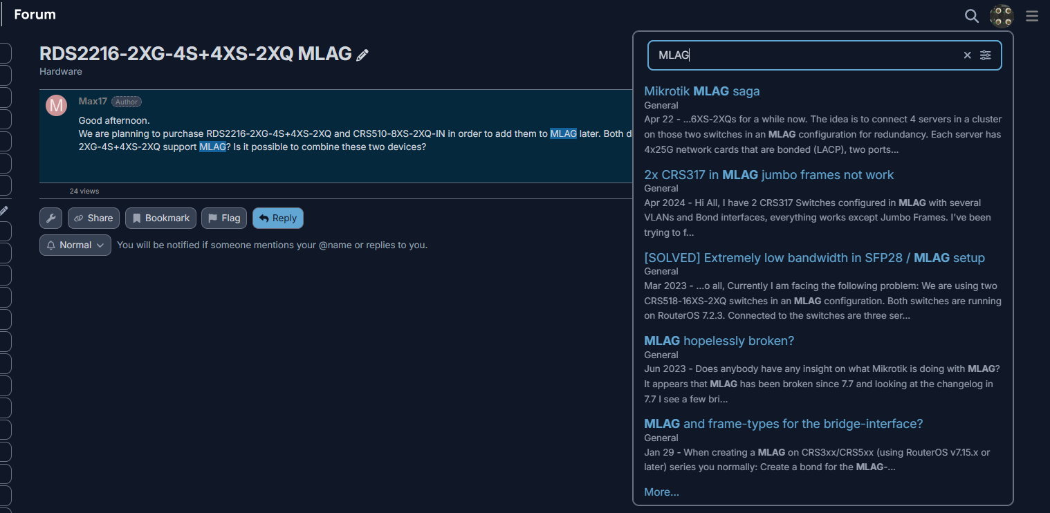

We are planning to purchase RDS2216-2XG-4S+4XS-2XQ and CRS510-8XS-2XQ-IN in order to add them to MLAG later. Both devices have the same chip. Does RDS2216-2XG-4S+4XS-2XQ support MLAG? Is it possible to combine these two devices?
Think that you should start MLAG story reading in advance these topics.
Not saying that there would be a problem, just to be aware of potential problems.
