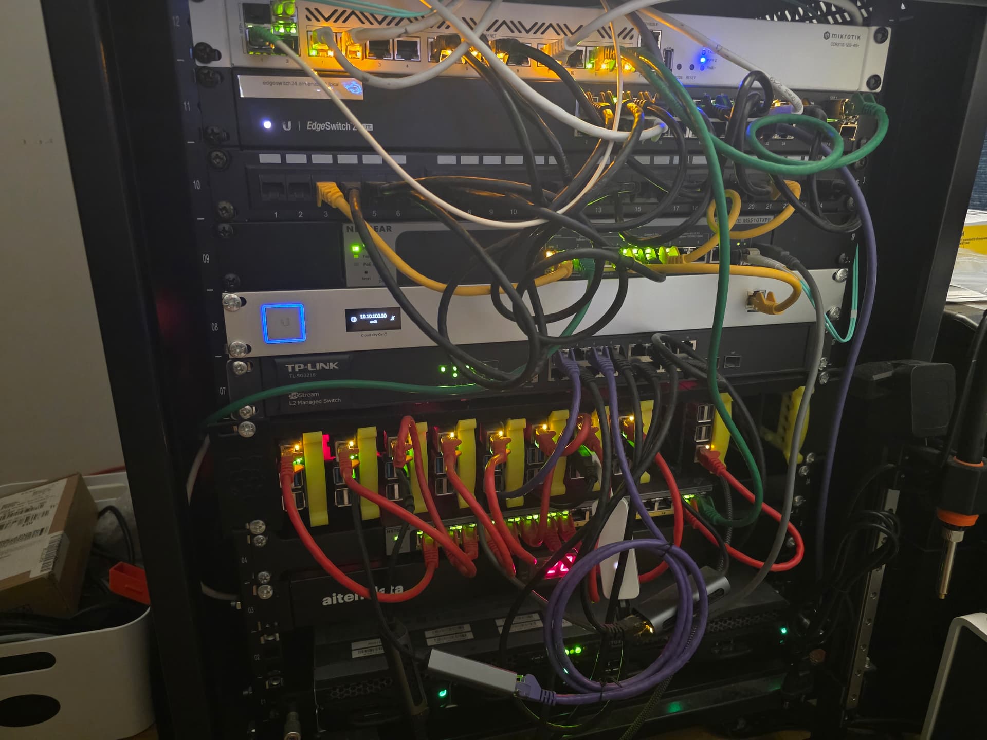

I am thinking of buying this model to replace a Netgear RN3138 NAS that is getting old and no longer receives updates. My main concern is that it will be located in part of the living room, so I need it to be quiet. For example, I currently have the CCR2116, and it makes no noise at all. With this modification, will it no longer be so noisy?
It is at the bottom of the rack and CCR on top.
