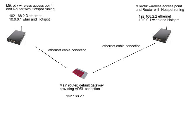

I have the following network setup; please look at the picture.
In my scenario I am having 2 hotspots, so for each hotspot I have to add separate users.
Is it possible to have just 1 hotspot for both routers?
so that for example:
If a user is created on the first hotspot, he can also log in to the second hotspot.
Thank you for help
You can run the same setup you have now. User Manager is probably what you need. That will allow you to use the same user database on both (or many) hotspots.
http://wiki.mikrotik.com/wiki/User_Manager

Hotspots should be the layer 3 hop for the users, so no, you shouldn’t run one Hotspot in front of both routers.
