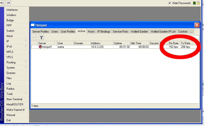

What i need is real time monitor of clients, which shows realtime uplaod/download rate of clients per IP address.
I found a great tool to do it here: http://forum.mikrotik.com/t/tool-realtime-per-ip-traffic-monitor-for-home-office/70028/1 (big thanks to the tool maker, its really great!!)
Still i wanted to know if there is an option, to do the monitoring directly through the RouterOs- Winbox, without having to run an additional server-computer and the utility.
You can use torch tool and filter by ip of user and interface for traffic monitoring in real time.

Activate hotspot on the router authenticate users by Mac address. The host list will you who is doing what. This also is an easy way to give different devices different bandwidth.
