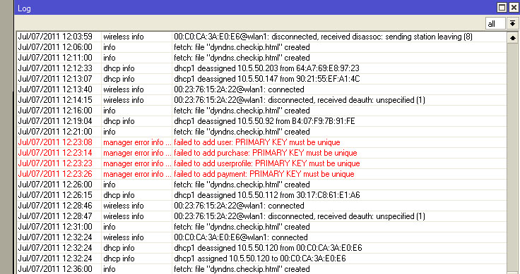

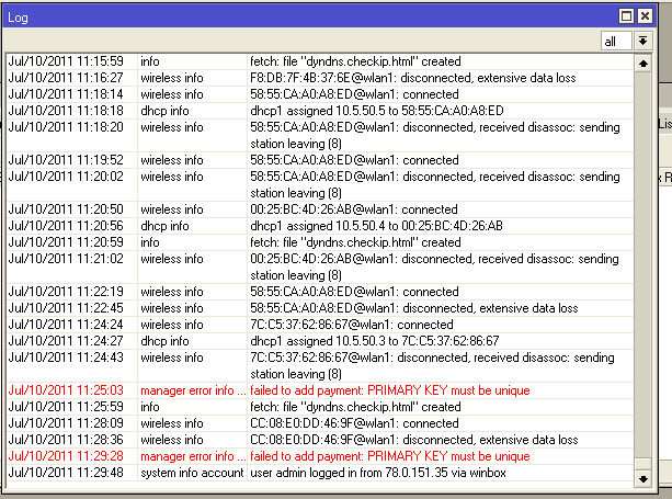

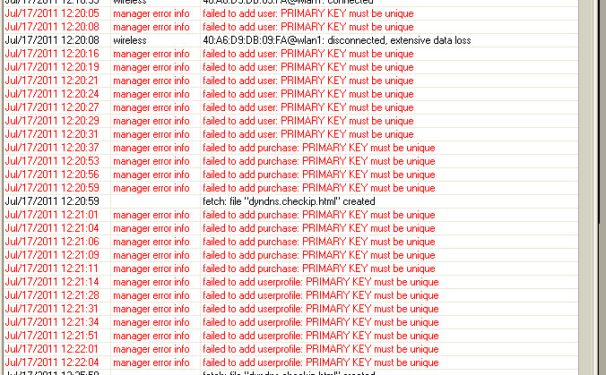

When trying to add a new user, and assign a profile to that user, I am constantly getting the error “error primary key must be unique”.
I always have to click 5 times or more until it accepts the user and profile.
have a look at the picture.
How to fix it?

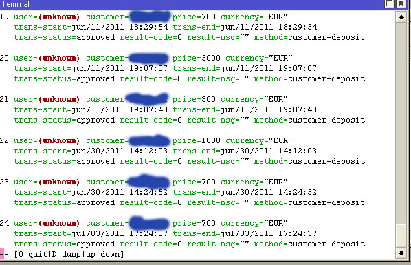

In my payment records under “tool user-manager payments print”, there are few payments with user=(unknown)
Is there a way how i can delete this payments records, cause maybe this is causing the problem?

I tried but there is no “remove” command under payments.
I can only print, but not remove
No remove? I don’t have V5.4, but I am surprised that command is gone. Did you check the available commands?
/tool user-manager payment
The question mark won’t show. It should display a list of what commands are available.
Yes, the remove command is missing.
When i check with “?”, only the following commands are available:

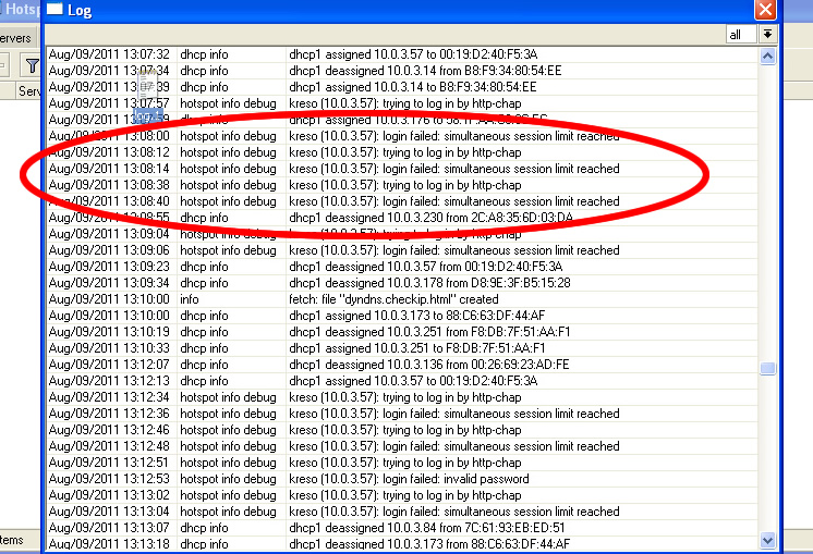

There is another bug in the new version.
User has logged out, but the User Manager shows the user as active.
The user is not possible to log in again, because there is an error “simultaneous session limit reached”.
Few hours later the user tries again to log in, but still the same error “simultaneous session limit reached”.
I tried to reboot the router, rebuild the database, everything, but the User Manager still shows that the use is currently active, and he is not able to log in again.
In winbox under hotspot there is no active users of course…
The only way i could solve the problem was to delete that user, and then create the same user again.
This has happened first in the log, after that the user was not able to log-in to hotspot anymore, because user manager reported him as active, even though he was not active.
Why do you think “simultaneous session limit reached” is a bug?
Perhaps shared-user limit is reached for the particular user (multiple sessions for one username).

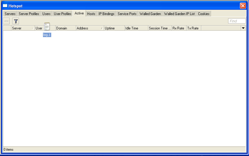

I think you dint understand my case :
There are no Active sessions for that user!!!
The user is not logged in at all !!!
There are no multiple sessions, there is no session at all!!
When he tries to log in it says “simultaneous session limit reached” .
The user manager just keeps showing that the user is still active but he is not!!

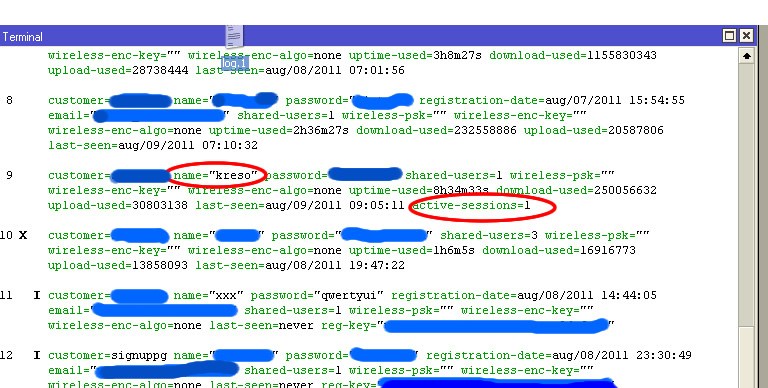

When checking via Winbox the user has last time logged out 5 hours ago and has not logged in again, also he is currently not active (of-course). But user manager just keeps saying that the user is still active, and doesn’t allow him to log in.
have a look at my 2.nd screen pictuer - the user is not active!!
Just the user manager “thinks” he is still active look at the picture nr.3

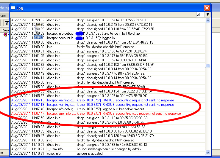

One time this problem happened when on our local router the power (electricity) went down for 1 minute, and the remote router with UM database was still active.
After we had power back on our local router, the user could not login- there was error “simultaneous session limit reached”.
On our local router in Winbox-Hotspot, there was shown that the user is not active.
But on the remote router under Tool-Usermanager-users-print- The user was still shown as if he was active.
An hour later the problem was still there (the UM keeps tracking the user as active even though he is not)
The problem was solved, only by deleting the user, and then recreating him again
I had the same problem like you in ROS 5.x in two location that i used mikrotik to core router.
First, i I change the hotspot from eth X to eth Y and when i used new hotspot on this eth Y it have this problem like you.
I solved this problem by close all session in userman and clear all log.
Second, i have some profile that have shared user=3 and some profile shared user=1.And when user log in more than one mac address
It show “simultaneous session limit reached” same with you. I think the user will try to log in more than shared user you define.
I think if you use some program ex. “mac maker” it will show you at the same error.
Sorry about my english. I have a little knowledge but I hope it can help other people.Pleas change to correct if it wrong.
Good, i didn’t know that in user-manager 5 there is an option to Force/Close active session.
I found it now, i think this could help.
