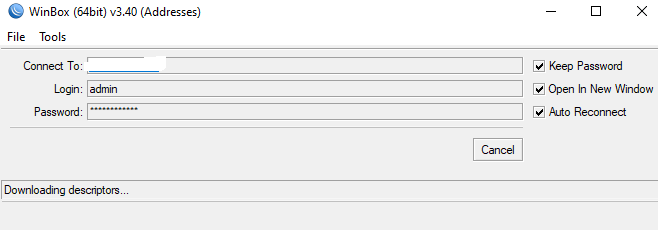

When i remotely access by winbox my mikrotik router its showing downloading descriptors and stuck,before 2days its working good,PLS HELP ME AND GIVE ME ADVISE

i am experiencing the same issue as well.

I am also having this issue, and I’m seeing many threads about this same issue. But there does not appear to be any solution. The only solution that I have been able to find is that logging in through the mobile app does work. So if there is an urgent change that needs to be made, the mobile app can be used.
I have the same issue twith winbox 3.41 and the 4 latest beta too.
I have a wireguard tunnel and a VPN server as well but same result connecting through both also not able to access through the web server too but I can access it via ssh without any problem.
I cleared the winbox cache and tried a different laptop.
Remote restart not help I even upgraded to 7.16 but winbox still can’t connect

Same issue using Wireguard, only ping and ssh are working.
I resolved the issue on Wireguard by lowering the interface MTU from 1420 to 1280.
