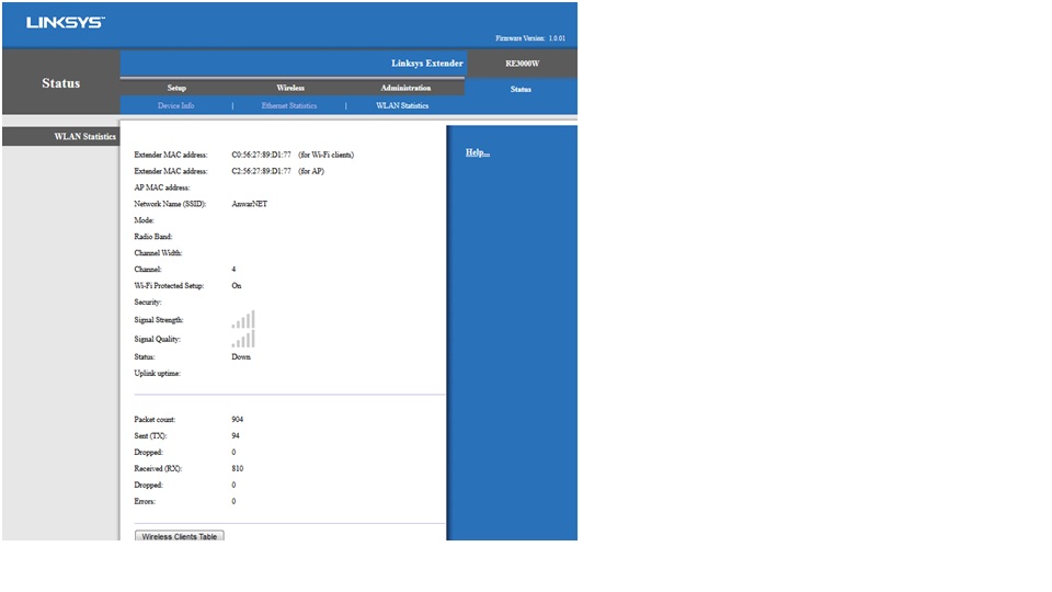

Introduce me, My name is Anwar from Indonesia. I have problem connecting RE3000W to Mikrotik Wifi because i want extend my Mikrotik Wifi for better signal. But always fail. Anyone please help me…

and the log is :
apr/19 03:44:06 wireless,info C0:56:27:89:D1:77@wlan1: connected, is AP, wants WDS
apr/19 03:44:10 wireless,info C0:56:27:89:D1:77@wlan1: disconnected, extensive data loss
apr/19 03:44:16 wireless,info C0:56:27:89:D1:77@wlan1: connected, is AP, wants WDS
apr/19 03:44:21 wireless,info C0:56:27:89:D1:77@wlan1: disconnected, unicast key exchange timeout
apr/19 03:44:26 wireless,info C0:56:27:89:D1:77@wlan1: connected, is AP, wants WDS
apr/19 03:44:31 wireless,info C0:56:27:89:D1:77@wlan1: disconnected, unicast key exchange timeout
apr/19 03:44:46 wireless,info C0:56:27:89:D1:77@wlan1: connected, is AP, wants WDS
apr/19 03:44:51 wireless,info C0:56:27:89:D1:77@wlan1: disconnected, unicast key exchange timeout
apr/19 03:45:21 wireless,info C0:56:27:89:D1:77@wlan1: connected, is AP, wants WDS
apr/19 03:45:26 wireless,info C0:56:27:89:D1:77@wlan1: disconnected, unicast key exchange timeout
apr/19 03:45:56 wireless,info C0:56:27:89:D1:77@wlan1: connected, is AP, wants WDS
apr/19 03:46:01 wireless,info C0:56:27:89:D1:77@wlan1: disconnected, unicast key exchange timeout
apr/19 03:46:31 wireless,info C0:56:27:89:D1:77@wlan1: connected, is AP, wants WDS
apr/19 03:46:36 wireless,info C0:56:27:89:D1:77@wlan1: disconnected, unicast key exchange timeout
apr/19 03:47:06 wireless,info C0:56:27:89:D1:77@wlan1: connected, is AP, wants WDS
apr/19 03:47:11 wireless,info C0:56:27:89:D1:77@wlan1: disconnected, unicast key exchange timeout
apr/19 03:47:41 wireless,info C0:56:27:89:D1:77@wlan1: connected, is AP, wants WDS
apr/19 03:47:46 wireless,info C0:56:27:89:D1:77@wlan1: disconnected, unicast key exchange timeout
apr/19 03:48:17 wireless,info C0:56:27:89:D1:77@wlan1: connected, is AP, wants WDS
apr/19 03:48:22 wireless,info C0:56:27:89:D1:77@wlan1: disconnected, unicast key exchange timeout
apr/19 03:48:52 wireless,info C0:56:27:89:D1:77@wlan1: connected, is AP, wants WDS
apr/19 03:48:57 wireless,info C0:56:27:89:D1:77@wlan1: disconnected, unicast key exchange timeout
apr/19 03:55:35 wireless,info 0C:98:38:C6:04:73@wlan1: disconnected, group key exchange timeout

Is there any body can help with this problem ? where the mistake?
