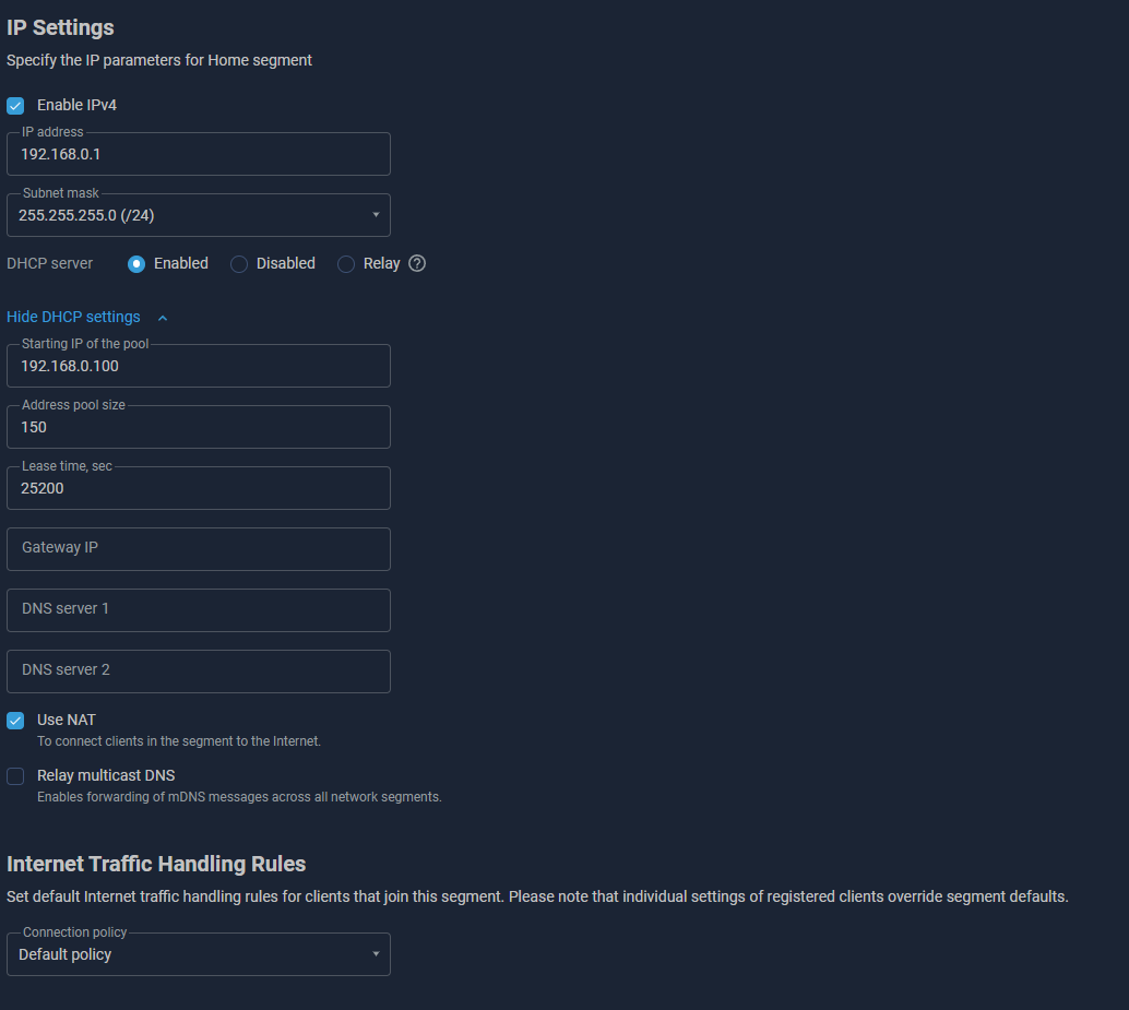

Whether you need NAT... that depends how the AP is configured & I'm not familiar with the Keenetic devices. Perhaps if you posted a couple screenshots of the AP's config that might help suggest a course of action.
Okay, I’ll look into routing on KN side, I know it’s possible to some extent. Here are my settings on the KN:
I’ll post more screenshots of whatever setting are needed. Thanks for the help again!

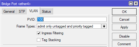

  5. Now it's the time to make port ether4, that the Keenetic is connected to, into an access port of VLAN 100 (adjust accordingly if you use another port). First, we set PVID to 100 on the port and set Frame Types to admit-only-untagged-and-priority-tagged.
    /interface bridge port set [find bridge=bridge interface=ether4] \
        pvid=100 frame-types=admit-only-untagged-and-priority-tagged
    Or use the GUI with WinBox, go to Bridge -> Ports, open the entry for ether4 and make the changes:

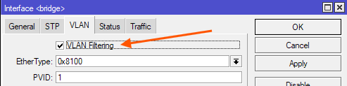

  6. Next is to enable VLAN Filtering on the bridge interface. Note: if your configuration is based on the default RB5009 configuration, and you have not done any VLAN work before on the router, then turning on VLAN filtering here is perfectly safe. The recent RouterOS 7 versions (≥ 7.16) will ensure that the necessary entries in the /interface bridge vlan are there for you. You won't have to worry about being locked out of the RB5009.
    /interface bridge set bridge vlan-filtering=yes
    Or use the GUI in WinBox:
    As you can see, there is nothing scary or complicated if you just need to add bridge VLANs using access ports to the router.
