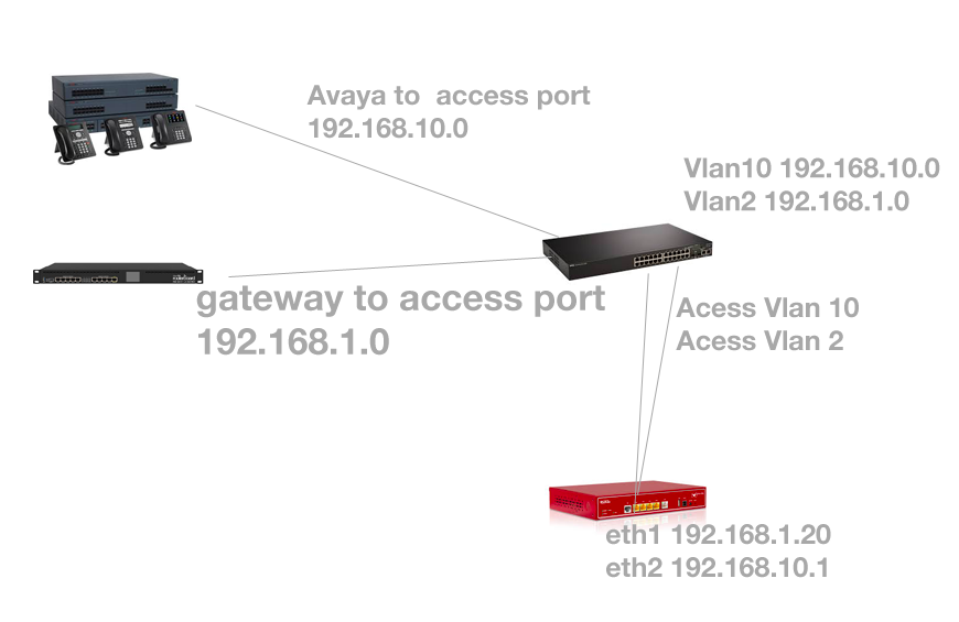

I try in words, picture follows tonight.
I have an Avaya Ip Telephone System wich is in a Voice VLan (192.168.10.0) and my client computers are in a Data Vlan (192.168.1.0)
The Vlans are not managed by a router, but on my Switches.
Both Vlan´s have their on ROuter and are connected to the Main Switch bia Access Ports.
To configure the Telephone System, the Guys from Avaya installed a little bintec Router to access the System via the Data VLAN.
So on our old Cisco Router we were able to access 192.168.10.0 from the Data Vlan. The Option allowing this was (allow multiple Subnets)
Everything but the gateway was installed by Avaya. Until now a Cisco Router was the gateway, but it needs to be replaced by the RB3011

I mean the network is set up with to subnets on the switch site, as far as I understand, the mikrotik router prevents me, from reaching the 192.168.10.0/24 network.
The option on my old Cisco router to allow multiple subnets, doesn´t route anything, it just allows connection to other subnets within the physical network apart from the network the gateway is hosting.
Or is the old Cisco Router (2006) able to perform any kind of magic which the mikrotik is not capable of (I certainly would´t think so).
p.s. would it be a solution, to have the two subnets on different interfaces, I could try to rip the old setup apart und build up something like this.
Sounds kind of like you’re describing Proxy-ARP but I’m not sure why it is needed. What is the device that looks like a switch in your drawing? Is it an actual L2 switch? What is the purpose of the RouterBoard to the left and the red box (WatchGuard) at the bottom?
In most cases if you “need” Proxy-ARP to get your network to work you’re probably doing something wrong. There are edge cases where it is useful and justified but largely it should be avoided.
At the end of the day, what is your goal? You want phones on 192.168.10.0/24 and other devices like PCs on 192.168.1.0/24 and phones need to talk to PCs and vice versa? Are the default gateways on the devices set to 192.168.1.20 and 192.168.10.1 accordingly?
Here is a mock up I did for another post. This demo’s how to do simple inter-VLAN routing with a single router. It doesn’t cover utilizing the switch chip features. This picture may help clarify what you want to do and how that may match up to your environment.
