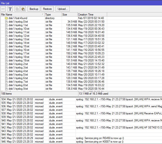

This prints the output that I see in Log but unfortunately I do not see syslog messages in the log only MT logs. It could be that I missed but is there a way to get syslog messages in Logs?
Dude uses the RouterOS logging functions to store the syslog captured.
http://forum.mikrotik.com/t/mikrotik-user-log-server-need/139561/1
Topic used is “dude”, action as you like (e.g. writing to disk).
The file is plain text and can be downloaded (or read while written? , didn’t test!) . I open it with PSPad or other text editor.
Thank you very much. This is exactly what I needed.
I was looking for syslog topic but it is dude(logical)
