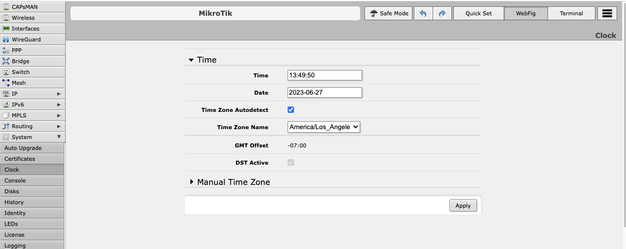

Why is my Mikrotik date wrong?
Do you have a valid NTP client configuration?
Use the “/export” command to retrieve the whole config, sanitize it of serial numbers and other sensitive info, and post it into a “code” block. Then we aren’t having to make guesses like this.
the clock and ntp client don’t work well together.
Nonsense. Citation needed.
# 2023-06-28 14:47:40 by RouterOS 7.10

So Mikrotik actually knows the right date, only the clock tab for some reason is one day behind.
Here’s the citation -
https://www.reddit.com/r/mikrotik/comments/l9j1v9/i_realized_today_that_my_mikrotik_was_with_the/
I guess some guy on Reddit is not so reliable.
Latest version (ROS 7.10.1) have some fixes with time on webfig.
Try to update, probably will fix it.
Regards.
I have not poked through your config, but I can tell you that on my RB4011 that has ROS 6.49.6, the System > Clock display is correct, as is the Dashboard Date & Time in WinBox. Also, log entries are showing correct date and time. In my case, I am using my own Stratum-1 time server.
I don’t normally use WebFig, but just as a test, I did start it. Also working correctly.
True, but I think the actual problem is that you misread what that top poster wrote. In your original post, you wrote “the clock and ntp client don’t work well together,” but that Reddit thread refers to the RouterOS “cloud” feature. Cloud, not Clock.
Moreover, the Cloud feature is disabled in your config, so that can’t be the problem anyway.
If an upgrade to 7.10.1 doesn’t fix it, then I’d check whether your ISP is blocking NTP queries. Believe it or not, some do!
He is using ROS 7.10 and is a known issue that is fixed on 7.10.1 theorically.
Regards.
Updating fixed it. Thank you.
