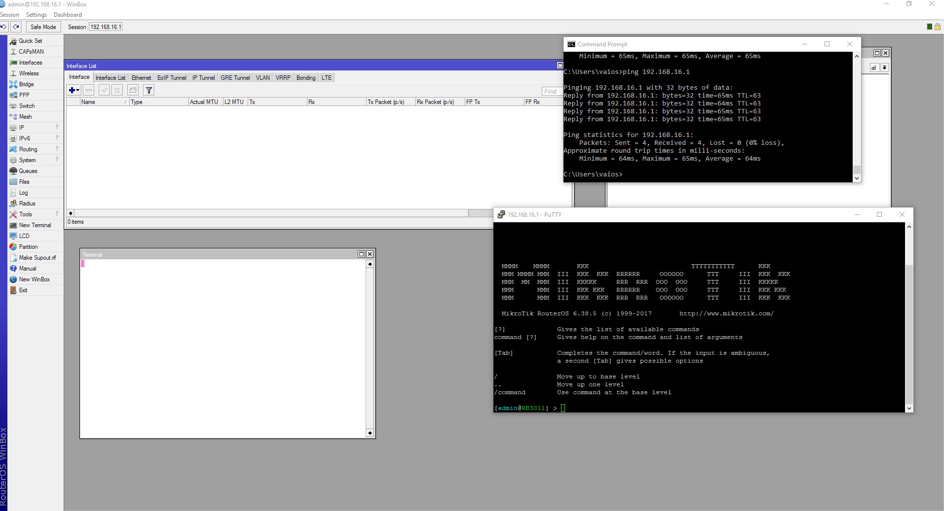

For example this is what I get when I log into winbox from a host in Tomato router domain (PPTP Site-To-Site). The winbox session disconnects after around 1 minute
Putty ssh connection and configuration works.
