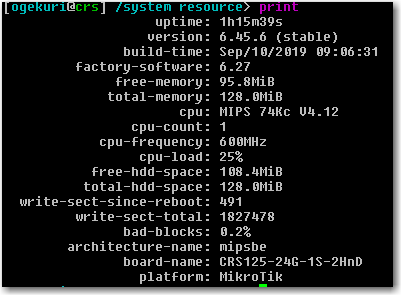

I’m look for an help to appoch to below issue, there is no information on the log, Can I make some changes to collect more information and investigate the issue?
Error:
OS Version:
Hardware:

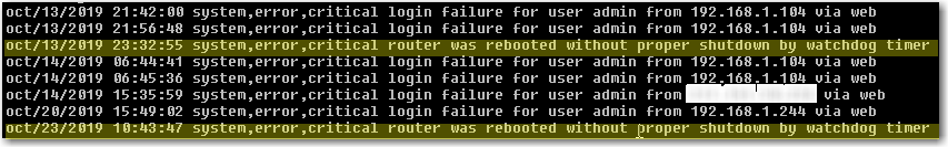

Goodmorning,
Error:
OS Version:
Hardware:
Reboot by watchdog timer is either because your router becomes unresponsive for a minute or you have added a watch address that does not reply to ping…
I don’t have watching address, I’ve checked my files but the support filen is not created.
Which are the reasons that can make my router unresponsive?
Very High CPU load, a software or hardware failure…

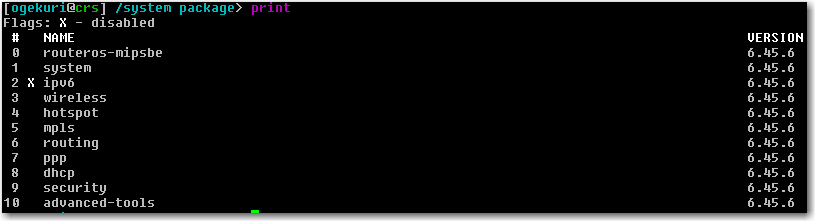

Go to system packages check installation and see if installation is ok…
Installation ok

After reboot you have small time to check the first lines of log. Or please set more lines in logs or set remote syslog to grab logs before watchdog work. Or set logs target to disk (but you have got 0.2% bad blocks).
