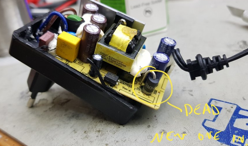

We have been purchasing hAP AC Lite TC’s (RB952Ui-5ac2nD-TC) for our customer base for quite a while and racked up a few thousand pcs of them.
Recently the last batch we received the PSU’s are failing in a fast rate - less than a month since installation. So far we had 5 PSU’s go down with the same issue - they short and are hot to the touch.
We sent them to a shop to investigate and the first answer we got was “the worst build quality you have ever seen”.

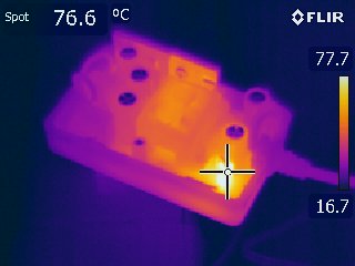

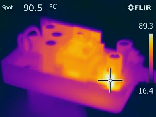

There is a diode that gets to 75c after 5min. When it gets hot its ratings drop and it cannot cope. Have in mind this is winter time currently!!!
Point of failure , diode goes to short and we have to pay to go and replace it.
Attached pictures indicating the problem.

Also putting that cap right next to it is quite stupid decision, caps don’t like being heated and this one will fail rather quickly if diode next to it gets up to 90 degrees (yikes! that’s almost fire hazard, hope the plastic case is not flammable, and in summer add 10-20 degrees more… that’s pretty bad)
