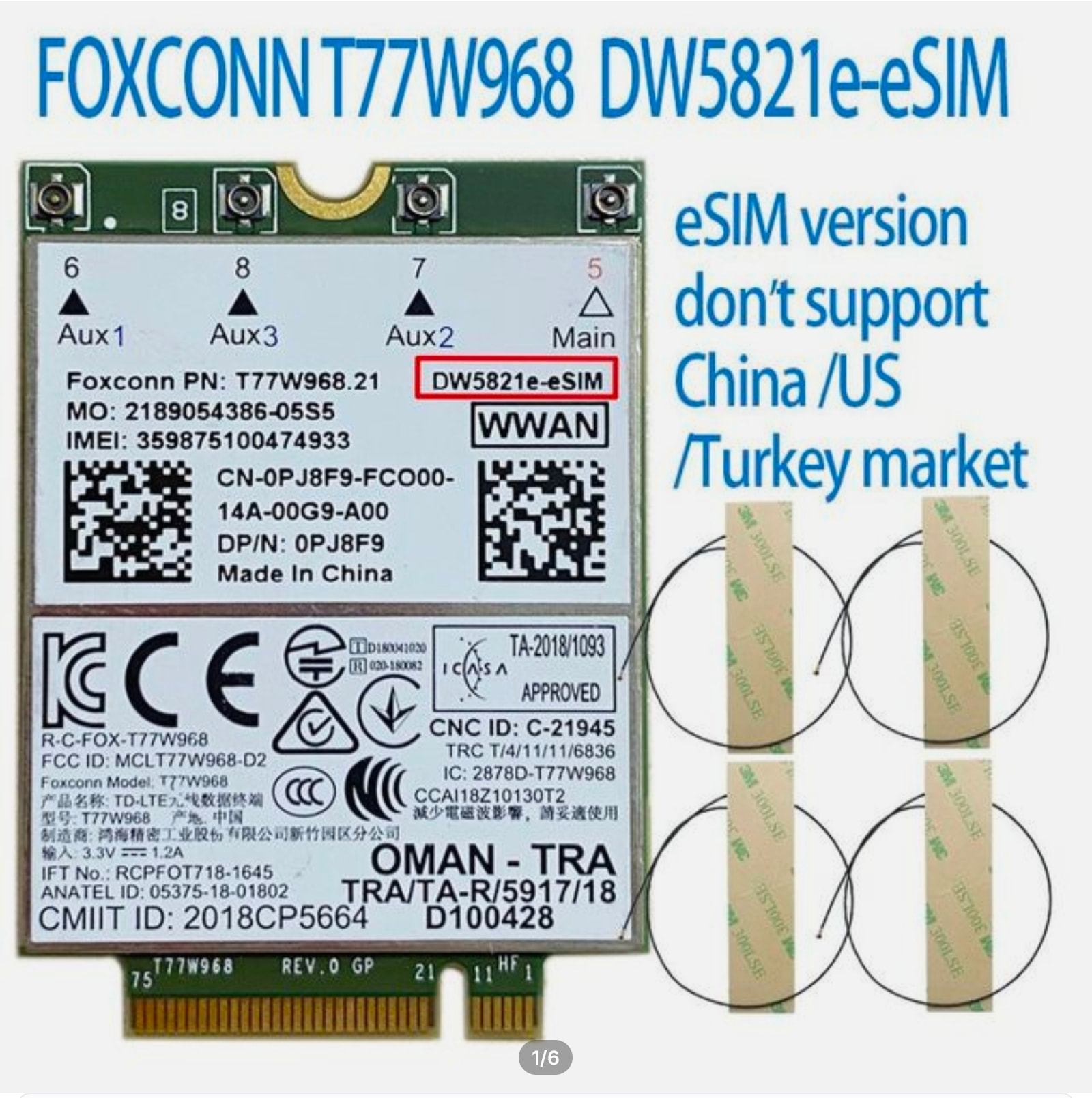

I’m using an LtAP mini with a T77W968-Esim modem.
It works great with the internal antennas, and all eSIM functions work correctly.

Should be Foxconn, and m.2:
https://fcc.report/FCC-ID/MCLT77W968-D1/4171002.pdf

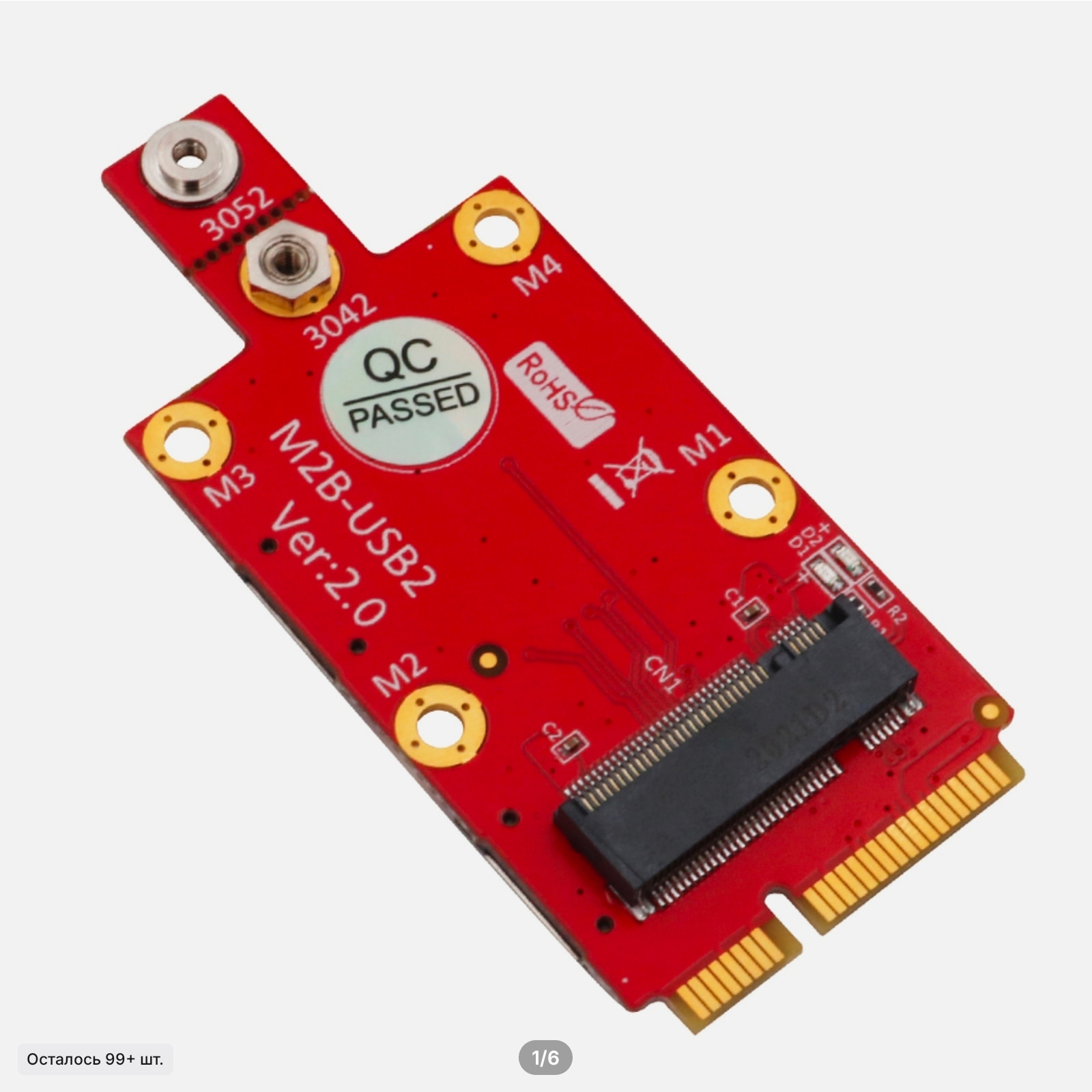

You also need m.2 to mpci adapter.

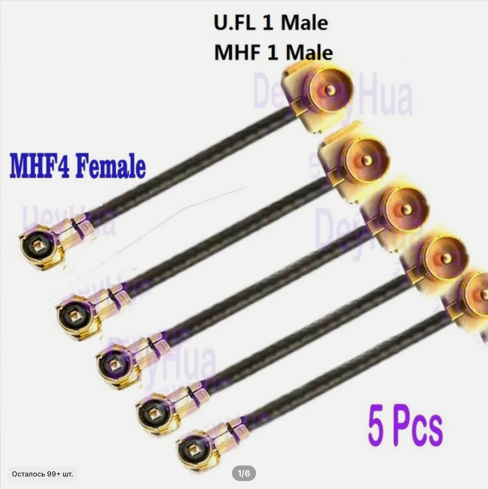

And if you want to use internal lte antennas - two IPEX4(F) to IPX(M) short 5cm cables.

Items photos
