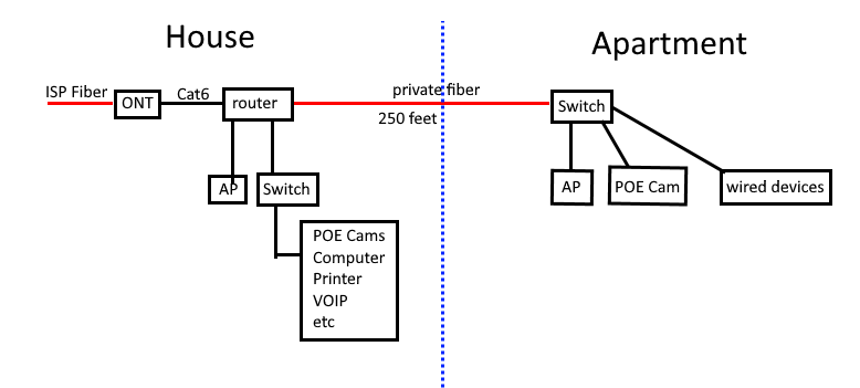

We’re getting fiber internet, and the company that plows the fiber to the house is also going to put us a fiber cable between the house and detached garage/suite building (independent from the ISP, about 250 feet long).
I’m thinking I’ll get a router and switch with SFP to handle the fiber directly (instead of separate media converters they mentioned).
I’m supposed to be talking to them to collaborate the type of termination - Is there a type that I should be trying to ask for? (most common, cheapest to deal with, etc)
Recommendations for inexpensive equipment? Comments on design? It’s not a high demand residence, probably the most demanding is potential POE cameras.
For example, I’m looking at the hEX S router. The picture shows the SFP under “internet” label, but in my case it would be used for LAN. Is it an issue to configure it such a way?
The router would also feed an AP and other wired devices/cameras in the house from the ethernet ports, probably involving a switch to get more ports.
In the apartment/suite at the other end of the fiber, get a switch that again has SFP for fiber. It would feed an AP and possibly wired devices and camera. Maybe something like RB260GS? With the uplink on SFP, I assume all 5 ethernet could be used for devices.
Enclosing a diagram of that layout I’m thinking.

Just about every Mikrotik router with a SFP interface ( what the fiber module goes into ) should work.
While they are laying your fiber ( house to shop/apartment ) , I might also suggest laying in two Cat6 ethernet cables in the same ditch/conduit.
You might be able to get 100 Meg ( possible 1-Gig ) on those copper Cat6 cables.
Also , those two cables could also be used for telephone land-lines.
Why not an RB5009?
It has one SFP+ port
One 2,5Gbps port (eth1)
And another 7 1Gbps ethernet ports.
More than enough to your needs, no?
When it comes to infrastructure prices, multi-mode fiber and SFP modules come cheaper than single-mode ones (the later is used by telecoms because it allows for much longer distances). Just make sure the cable is OM-3 or higher, lower-specced cables don’t support 10Gbps at those distances. If budget permits, go for OM-4 to be on the future-proof side. And have the cable installers terminate it with SC connectors. I’d suggest you to install cable with N*2 fiber strands, for duplex communication a pair of fibers is usually used and you want to have more than one pair for possible future expansion. Multi-strand cables are not much more expensive, splicing (terminating with connectors) might be more expensive than cable.
You can use any Mikrotik router with SFP/SFP+ port as a switch, functionality of each port is freely configurable (WAN/LAN) regardless of case inscriptions. However switching performance can depend on device model, some devices have SFP port connected to switch chip (good for switching performance between SFP port snd the rest of ports) and some devices have SFP port connected directly to CPU (good for routing but not so great for switching performance as CPU will have to deal with traffic). All (but recently announced) devices have block diagram published in their product pages and you can check the connection of SFP port there.

If you are on the cheap, you can get away with two RB260GS’. one on each side of the 250 feet fiber, list price 2x$39.95.
The “main” router (in the house), for the low speeds you are going to get from the ISP, could be an Ax2 or Ax3 (99-139$) and you would save one AP.
Or even an Ax Lite (if you don’t need 5 GHz radio) for $59.

Well, if you hadn’t this “fiber opportunity”, anyone would have advised you a CAT6 cable, 1 Gb speed.
With the two RB260GS, you need (for single mode fiber) two of these:
https://mikrotik.com/product/S-31DLC20D-181
and thus get a 1.25 Gb connection.
A camera feed may be what 10-15 Mbps?
Higher resolution ones possibly 25 Mbps.
With 10 cameras full streaming you use in theory 1/5 of the link, you shouldn’t have issues.

I’ve been pondering over different layouts and coming back to this thought. It might not be a bad way to go if I’m thinking right.
My automatic initial reaction was to connect the fiber as directly as possible (i.e. router), potentially for “best” internet performance. But going to the switch does free up to do anything for the router.
For example, I’m seeing a “hEX refresh” which is actually cheaper than the hEX S. It seems like it would have significant better specs (I’m not sure how the CPU compares but has more RAM/storage). And looks like a recent release so potentially more updated/longer supported in the future?
Or as you say it could be something with wireless, although I was thinking an AP in a better location.
Also, a lot of the fiber traffic would potential be from a camera(s) to the NVR, and fiber going to the switch could keep that traffic off the router altogether.
But then with the kind of load this will see it’s probably irrelevant lol.
