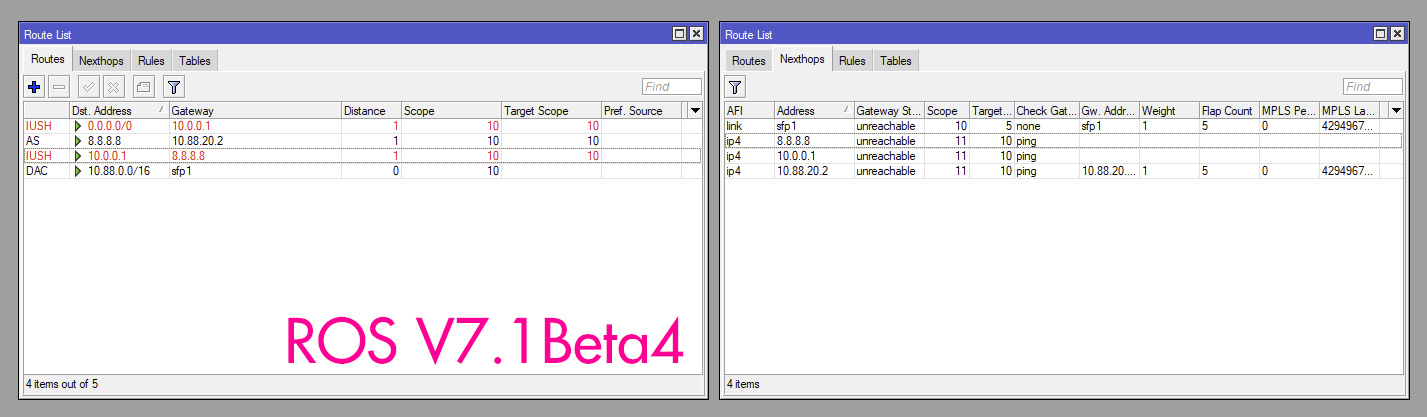

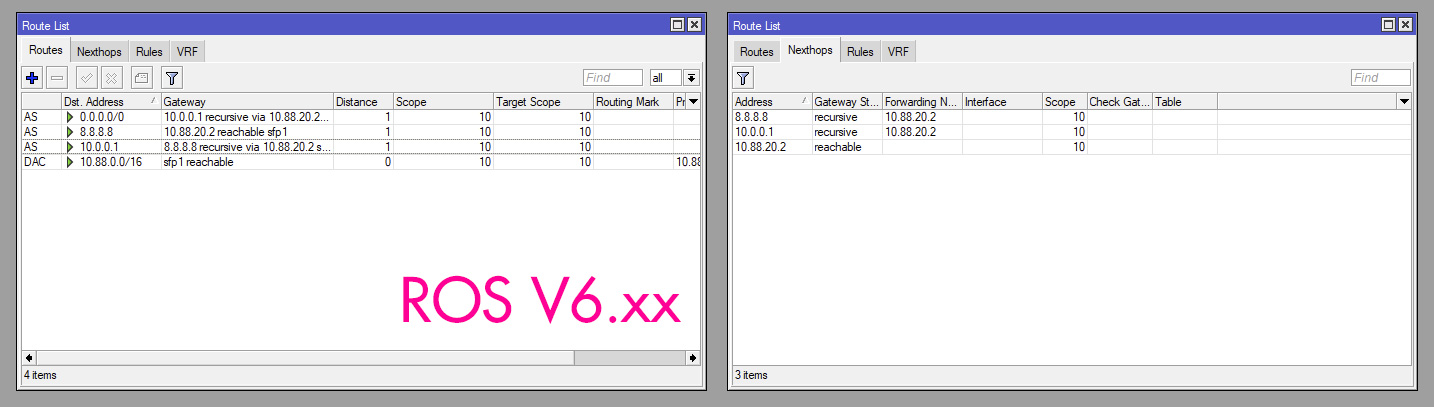

is this the “normal behaviour” of V7 regarding recursive routes?
Like described in the popular thread “Advanced Routing Failover without Scripting”: http://forum.mikrotik.com/t/advanced-routing-failover-without-scripting/136599/1
With V6 everything works:
With V7 there is no “recursive” routing?! All I see is in red “invalid” or “unreachable”:

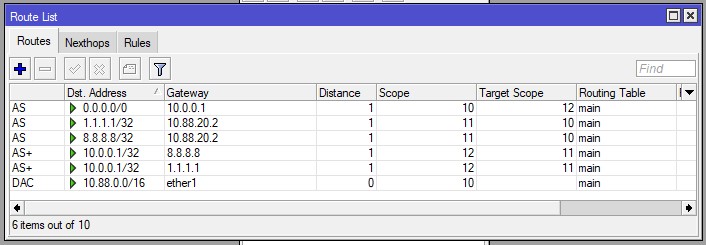

For everyone who wants/needs to cheat, this works:
Single WAN-Check:
Multiple WAN-Check:
Still missing a notification “recursive via…”…
To simplify a bit, you can set scope=10 everywhere :slight_smile:

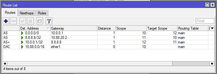

Could you explain the “logic” behind? Why do I have to enter a Target Scope of 12?
As far as I understand it goes this way (from top to down):
Dst.Address: 0.0.0.0/0 → GTWY: 10.0.0.1 → Target-Scope: 12
Dst.Address: 10.0.0.1 → GTWY: 8.8.8.8 → Target-Scope: 11 [at this point happens the magic aka gateway check]
Dst.Address: 8.8.8.8 → GTWY: 10.88.20.2 → Target-Scope: 10
Dst.Address: 10.88.20.2 → GTWY: ether1 → Target-Scope: nothing
Why do I need a Target-Scope of 12 for the first route, when the second/all other have a scope of 10?!
Why is 11 not enough but its enough for the second route? I mean 11 is even less than 10 (“not less or equal”)?

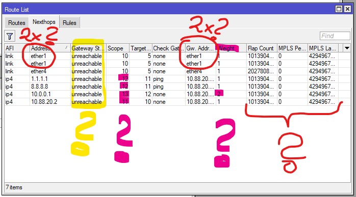

Can anyone explan this:
Why has the Scope here other values as in the Routes page?
Target-Scope of 5? I cant see anything on the Routes page?
Why is ether1 listed two times?
What is “weight” and why is there a line with a “2”?
Why is the “Gateway State” unreachable? The Gateway(s) are reachable?!
What is Flap Count and that MPLS-stuff? I dont even use MPLS…
Why do they make ROSv7 so complicated and cluttered with useless stuff :confused:
If THIS is the way they design ROS7 - thats catastrophic - there is no logic, no sense, no documentation, nothing.
