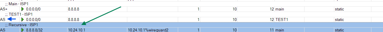

See this screenshot
from this post of mine yesterday http://forum.mikrotik.com/t/finally-made-dual-wan-work/182174/1
It’s also better to refer to the remote WireGuard peer that will do the routing to the internet with its IP address (as example 10.24.10.1 in the screenshot, instead of the interface name (wireguard2 in my example)).

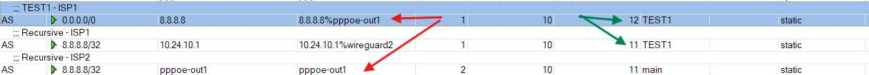

Unfortunately, I’ve tried giving canary destination 8.8.8.8 two different routes in the “main” and “TEST1” tables, but my test has shown that the route in the “main” table is preferred over the one in the same table:
Which means it’s not the solution for this issue of yours:

I am aware of it, the post from yesterday that I linked above has the routing rules http://forum.mikrotik.com/t/finally-made-dual-wan-work/182174/1 What I wanted to show here with the screenshots is only the behavior that when using recursive routing, the rule in the non-main table will expect the referenced gateway to have a route in the main table, and that route is preferred. In the screenshot above, the relevant route is for destination 8.8.8.8/32, not the route for destination 0.0.0.0/0 (that will be used together with routing & mangle rules).
