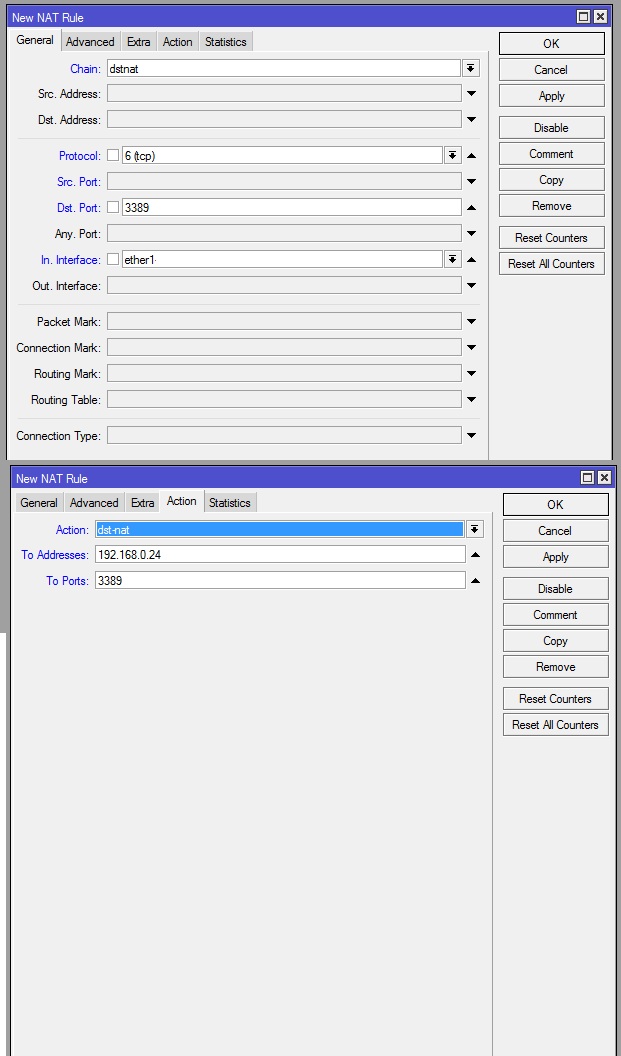

You need to set up a DstNat rule on both routers.
In winbox: IP->Firewall->NAT
Router-1: Add a rule, DSTNat-ing anything arriving at your internet-facing interface, bound for port 3389. DST-Nat that to the IP of the next router, port 3389. (See attachment)
Do the same on Router-2, modifying the interfaces and IP’s as necessary. DST-Nat the traffic to point to your PC’s IP.
If you want to change the listening port (Because your ISP may block port 3389) just change the listening port on Router-1. Router-1 will change the destination port to 3389 when it performs the DSTNat.

It worked! I just have done it for my mikrotik and it worked properly. Thank you. I’ll come back with pptp dialer, i think it will be the same as it is.
