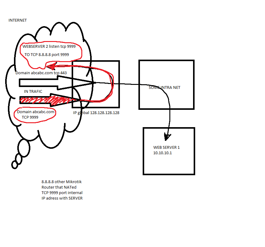

How redirect incoming WAN TCP port 9999 connection to public ip 1.2.3.4 with port 9999 that accessible from WAN.
Please draw a diagram of what you speak as what you wrote makes little sense to me.
Trafic not big maybe some megs
Main goal that 128.128.128.128 got SSL signed and payed certificate but webhook service hosted at other machine with other gloabl ip i want to reroute trafic that comes with to 128.128.128.128 to port 9999 with domain name abcabc.com to other gloabal ip 8.8.8.8 that gonna router local server machine. Main proble that domain abcabc.com has other services that has be inplace that works now with reciving traffic from other ports as it is.
The “red” traffic will likely only pass bi-directionally if you’ll implement hairpin NAT for that “public to public” NAT. Without it, webserver 2 will try to reply to client (accessing abcabc.com:9999) directly, but client will reject this as it will try to talk to your router’s WAN IP address.
Hairpin NAT means, that server doesn’t see the real client’s IP address, it sees the NAT device’s IP address. In certain cases this is a deal breaker, in some cases it’s a nuisance (lack of observability on server) and in most cases it’s not a problem at all.
can you give me solution to try i’ve tryed to add src-nat tcp port 9999 mascarade it doesnt help other remote router doesnt see any init connection to it

@anav: you’re pretty close to how I understand it. Just that @OP wants to forward connection (initially targeting his router port 9999) to some host on intetnet (same port 9999).
