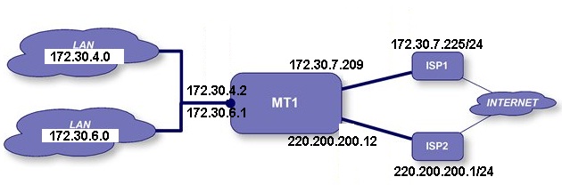

OK This is my Settings
add address=172.30.7.209/24 broadcast=172.30.7.255 comment=“” disabled=no
interface=ISPONE network=172.30.7.0
add address=220.200.200.12/24 broadcast=220.200.200.255 comment=“” disabled=
no interface=ISPTWO network=220.200.200.0
add address=172.30.6.1/24 broadcast=172.30.6.255 comment=“” disabled=no
interface=Internal network=172.30.6.0
add address=172.30.4.2/24 broadcast=172.30.5.255 comment=“” disabled=no
interface=Internal network=172.30.4.0
add gateway=220.200.200.1 routing-mark=ISP2
add gateway=172.30.7.225 routing-mark=ISP1
/ip route rule
add dst-address=172.30.4.0/24 action=lookup table=main
add dst-address=172.30.6.0/24 action=lookup table=main
add dst-address=172.30.7.0/24 action=lookup table=main
add dst-address=220.200.200.0/24 action=lookup table=main
add src-address=172.30.7.0/24 action=lookup table=ISP1
add src-address=220.200.200.0/24 action=lookup table=ISP2
add routing-mark=ISP1 action=lookup table=ISP1
add routing-mark=ISP2 action=lookup table=ISP2
/ip firewall mangle
add chain=prerouting src-address=172.30.4.0/24 action=mark-routing
new-routing-mark=ISP1 passthrough=no
add chain=prerouting src-address=172.30.6.0/24 action=mark-routing
new-routing-mark=ISP2 passthrough=no
Use the following OPEN DNS
208.67.222.222
208.67.220.220
with this setting the network 172.30.4.0 peroutimg to ISP1 and the network 172.30.6.0 peroutimg ISP2
When I enable web-proxy the two networks 172.30.6.0 and 172.30.4.0 takes from ISP1 only
DO you have another solution
