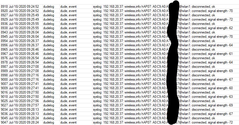

As far as I know authentication is not limited in time. I have clients connected for several days.even months.
Somebody walking around with a smartphone and therefor disconnects sometimes, reconnects within the same second.
I’m using WPA2-Enterprise (Radius/802.1x) for authentication.
