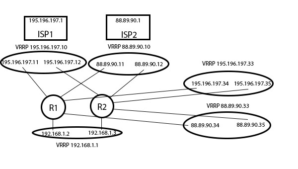

After reading more about VRRP i would like to know if makes sense something like this.
I’m coming from current situation with a DMZ like this:
And i’m wondering if make sense to create multiple VRRP interface like this:
That is certainly a possibility. You then have to decide how to deal with certain failure scenarios. e.g. If the power is pulled on R1 then obviously R2 should step up and become the primary IP on all those networks. On the other hand, do you want the possibility of a failure scenario where R2 becomes the primary on one of the ISPs but is still the secondary on the DMZ/LAN (say a sable knocked out by accident)? How you deal with this depends to a large extent on which failure scenarios you wish to protect against. RouterOS does support scripting on VRRP up/down so you can create fairly flexible solutions.
While doing this configuration via VRRP is one possibility, it will give you hardware redundancy as well.. but you can see that the complexity of setting this up to work properly is greatly increased…

You are right, i haven’t set my goals!!
What i’m trying to accomplish is router redundancy ( if main router goes down or hangs), ISP redundancy (internet navigation and server publishing).
I could publish my webservers, mail servers, FTP servers etc. with 2 different static IP addresses from 2 different ISPs in the DNS.
And of course provide internet navigation redundancy.
If i need some special feature i could use policy routing.
What do you think about this?
thanks in advance
