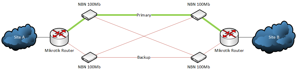

I have two sites (Site A and Site B), both have dual 100Mbps connections. We would like to create a redundant VPN between the sites in an active/standby type arrangement. i.e. use the primary connection unless its unavailable. I’m looking for recommendations as to what protocol to use. ie IPSec, OVPN, GRE?. In addition, if you’re aware of any guides that would also be appreciated.
The ideal scenario would be this
However, this could also work

I have a config like that and I use GRE/IPsec and GRE6/IPsec tunnels with autorouting using BGP. OSPF would work too.
It is easy to setup on MikroTik: just create the GRE tunnels and enable the IPsec checkmark + put a key, then
put /30 addresses on the tunnels (the lowest addresses will have preference) and add BGP peers for each tunnel.
Add the networks you have at each site to BGP networks and it all works. When you want quick failover, check BFD
on the BGP peers.
