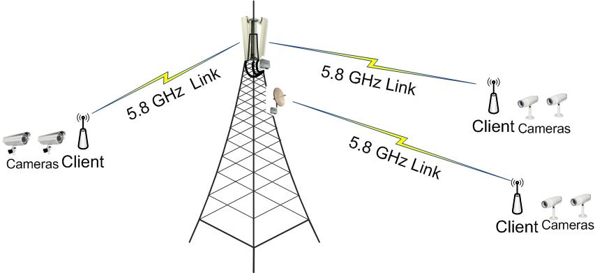

We have installed multiple surveillance camera at different locations, which are connected via Mikrotik 433ah on Point to Multipoint network on 5.8 Ghz
At central side we have a 2nos RB600 with 3nos 5 GHz sector antenna connected to 433ah with 3 R5H card each
For some long distance link we have some Point to Point Links working on 5GHz using Mikrotik
At client side we have RB433 with R5H card connector to 5 GHz dish antenna
At all client side we have Surveillance camera installed
  • Problem
  • When we enable multicast in the camera’s encoder the wireless link get choked, on unicast mode everything seems to work fine
  • The entire setup has been done in Access Point / Bridge (at Central Side) and Station WDS mode (At client side), we want to disable cleint to cleint communication to prevent unnecessary Broadcast (does client to client communications gets disabled by disabling default forward in WDS mode)
