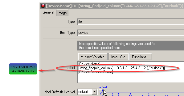

string_find(oid_column(“1.3.6.1.2.1.25.4.2.1.2”),“outlook”) will return positon of “outlook”, if not found it returns 4294967295
While making new probes you shoud first put function on device label to know exactly what it returns.
