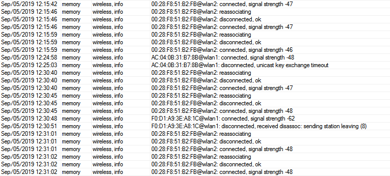

Just in the last week my hAP ac2 (only a month old) has begun to drop my wireless signal regularly (I have it setup as an access point).
This is what the logs show:
Oddly enough, I get drops on my devices connected to the 5G which is wlan2, despite seeing wlan1 with timeouts and disassoc in the logs.
Any idea what might be causing this.
Two months later and I’m still haven’t sorted this issue out. Devices (phone, tablets, laptops) regularly just disconnect from the 5G network, most reconnect within seconds though (though sometime the laptops take a minute or two).They don’t all appear to disconnect at the same time, anyone have any clue were I should looking to try and resolve this. This is a real pain when I’m VPNed and double RDPed into a remote system while on a meeting for work and everything just drops.
