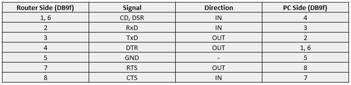

http://forum.mikrotik.com/t/cannot-reinstall-rb1000/66357/1
please make serial cable as mention here
