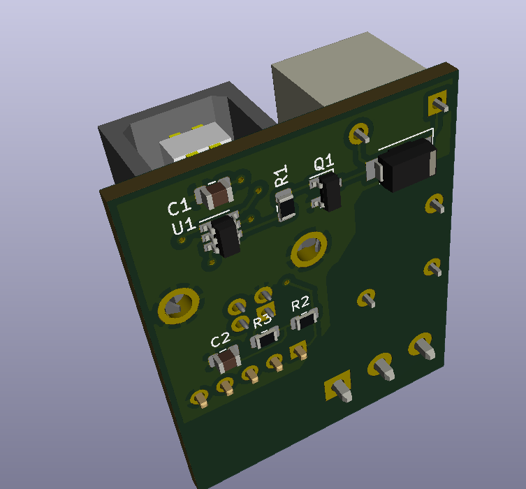

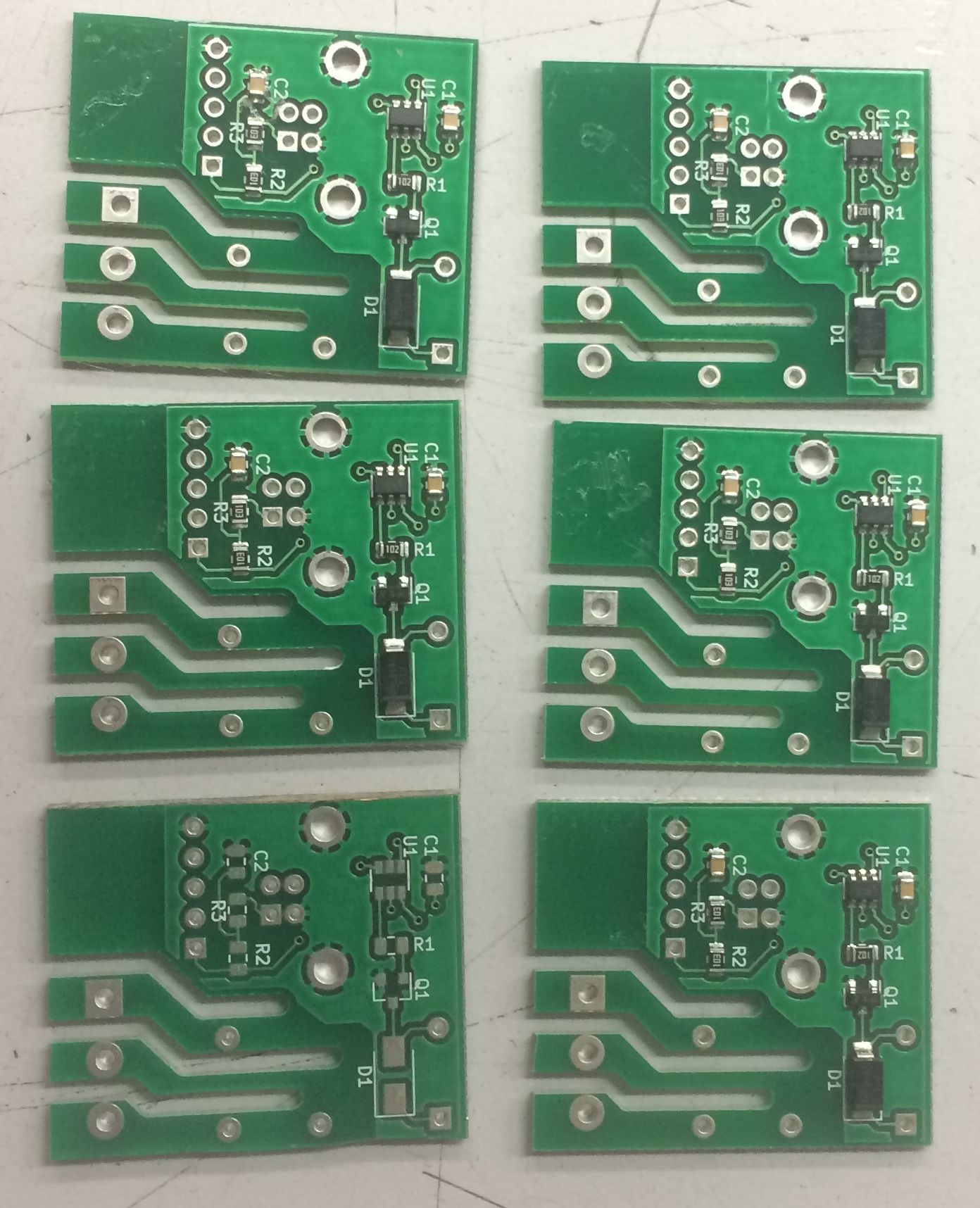

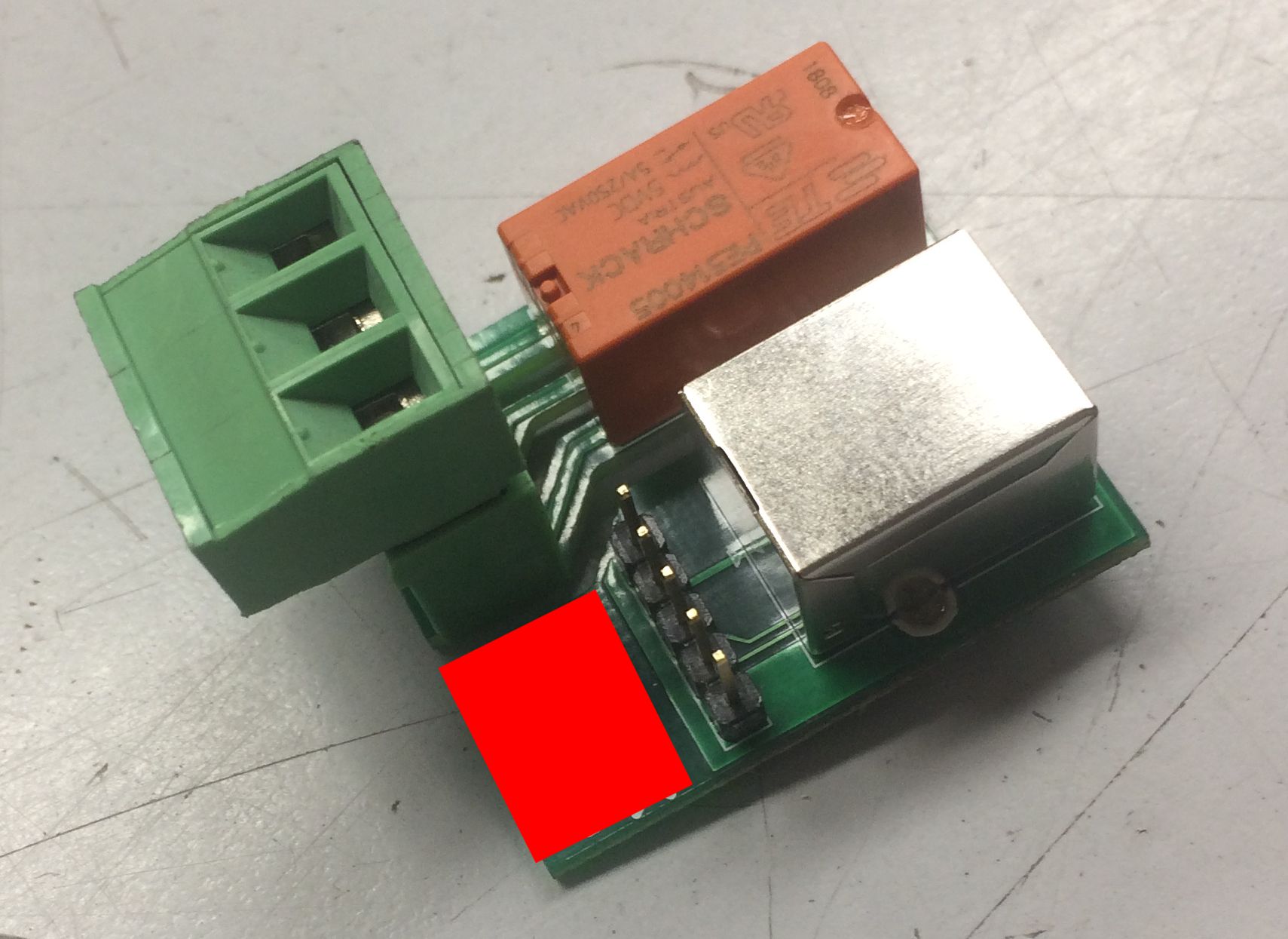

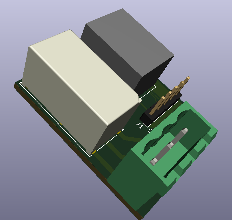

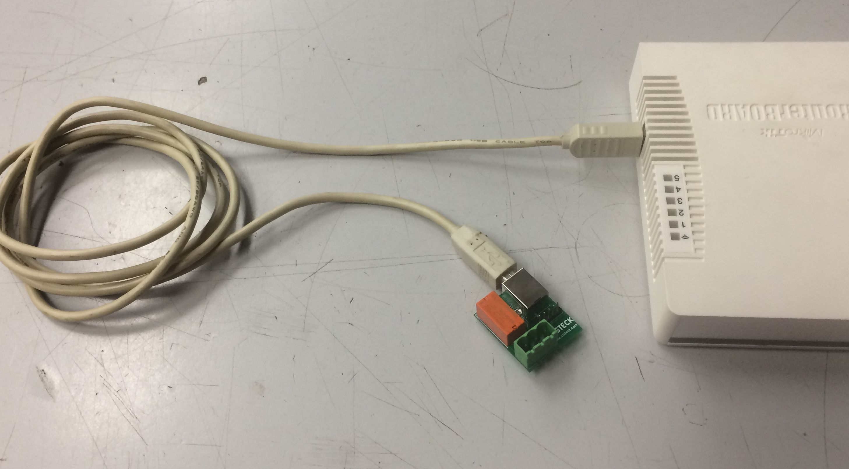

I built a small hardware that connected to the mk usb socket and using the command “usb system / power router reset-duration = 5s” allows to act as a power switch to solve the problem explained.
Since the MK’s USB port is always powered I did NOT simply insert a 5V relay in parallel with its power supply, because in this case I would have, even if little, a continuous consumption of the relay coil.
I solved by entering a minimum of logic and using the NC contact of the relay, when the relay is not active, the power supply switches.
Because everything works of course the MK must be reachable :slight_smile:
