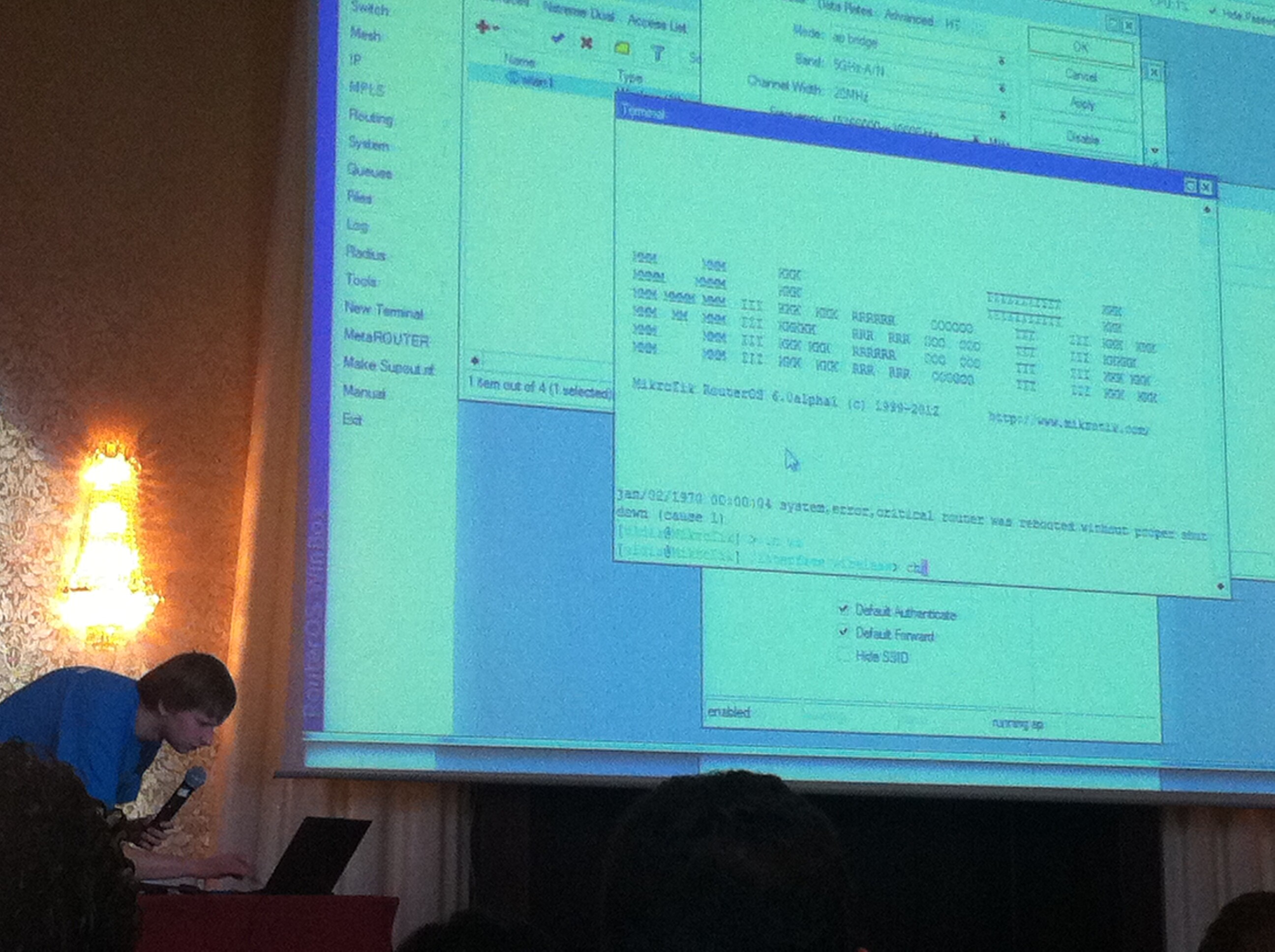

During the MUM wireless workshop I saw, that Uldis is using ROS ver. 6.0alpha1.
Regards,
the current test build:
6.0 data 30.01.2012 (pause?)
5.15 date 15.03.2012 (=6.0alpha1+new capabilities, enhancements, and corrected errors)
This photo was taken at the MUM. When I saw ROS V6 Aplha my face was
Regards!
