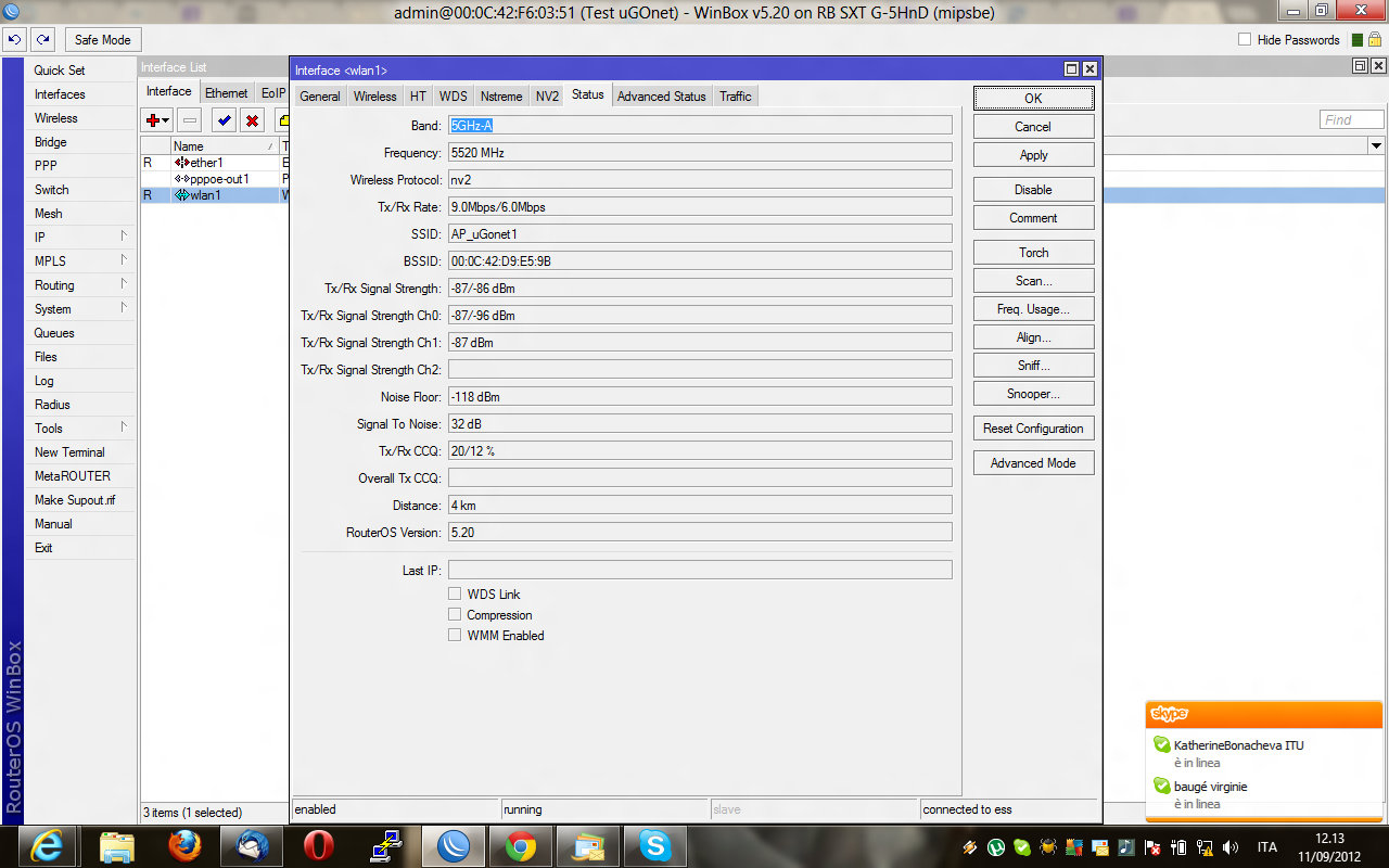

i got the following link.
Is the signal to weak to connect?
is there any test I can run between an AP and a CPE?
thanks
thanks
the signal is very bad, it will most likely disconnect often. your signal should be between -70 and -50 for a good link.
