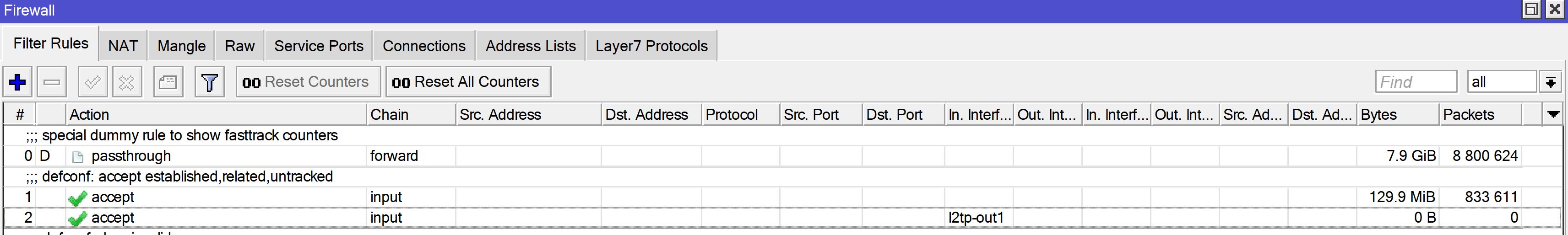

At your Mikrotik you must then allow in the Input Chain access from the L2TP Interface, in case you block access in the input chain from non LAN Interfaces…

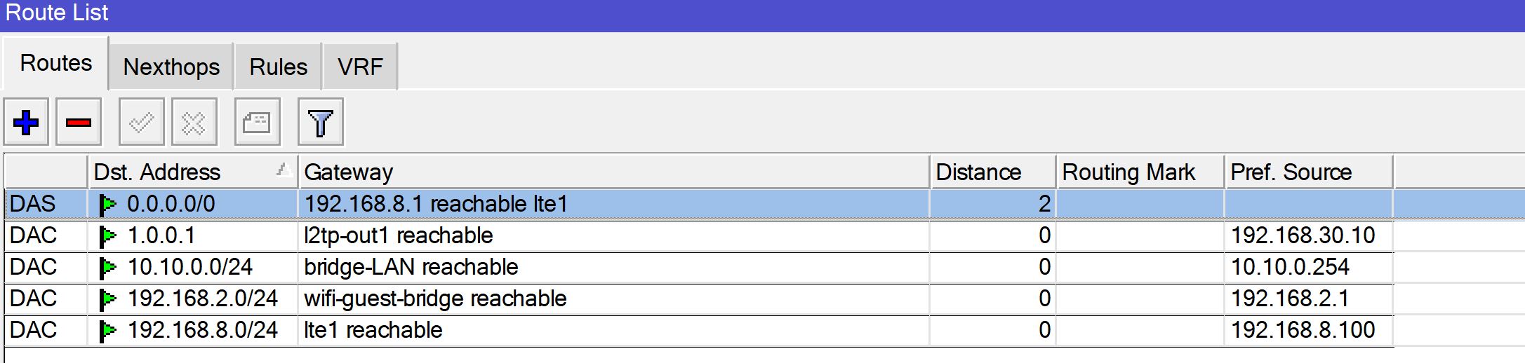

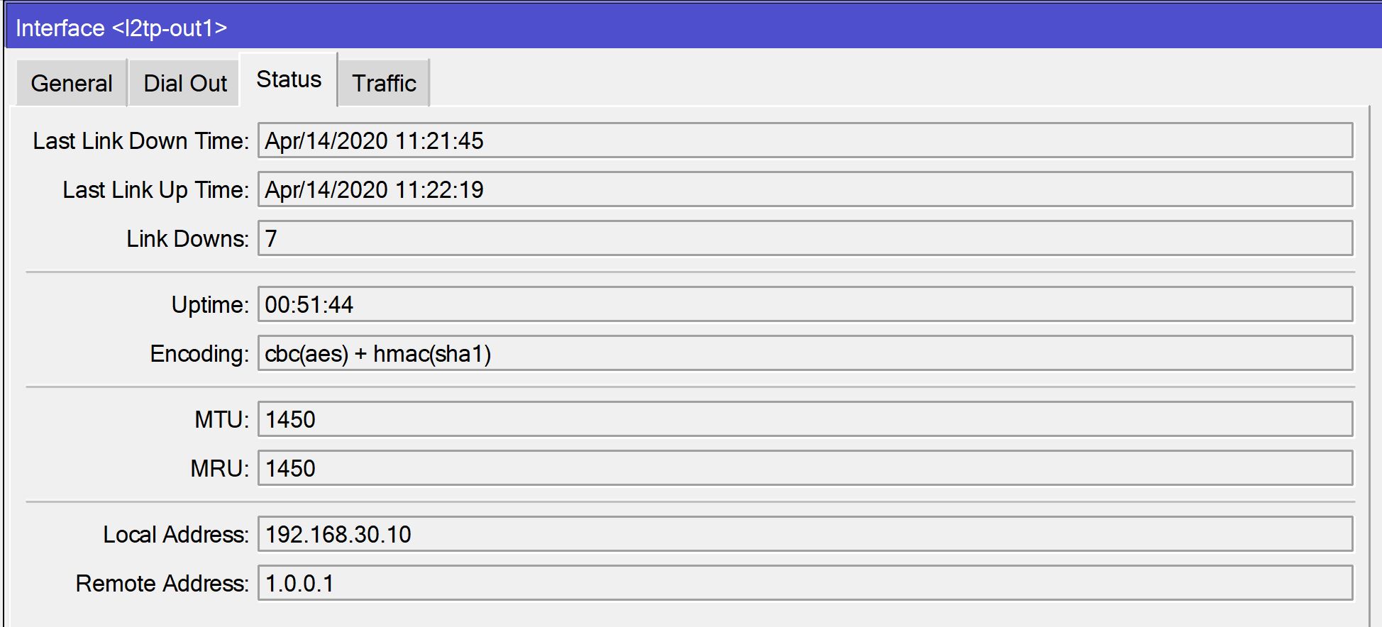

Hello.
Thank you for all the answers.
As I mentioned, I can establish communication with my office server and everything is ok from its side.
Unfortunately I still cannot connect to Mikrotik via Winbox from my office.
Please see attached screenshots for your reference.
I believe the problem lies on Mikrotik side and its configuration.

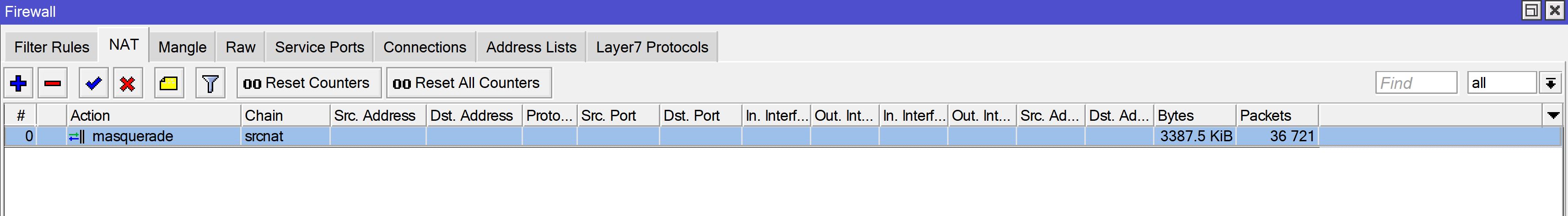

Can i see your NAT rules as well? Unless anything strange happens there, your office router possibly blocks you…
Please see below:
