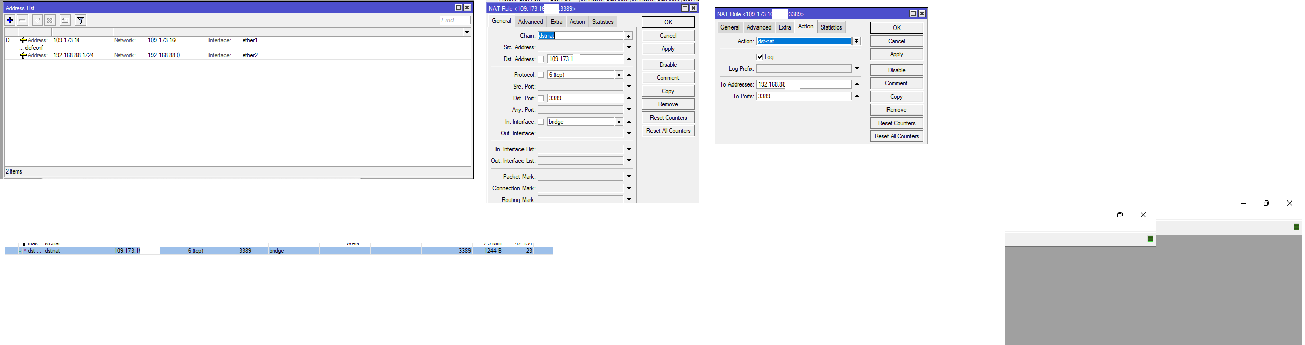

I want to configure port forwarding from Internet to my local machine, but I have a some problem. I not able to connect to PC
[] MikroTik RouterBoard hAP ac3 (D53iG-5HacD2HnD) os 6.46.8 → Port Forwarding 3389
] Windows 11 Pro (RDP enabled) locally we can setup connection
[*] MikroTik cloud DDNS enabled
My conf is shown in attached picture.
Diagram: Internet → Modem as bridge → Mikrotik hAP → PC all is connected over LAN
What should I check to determine the reason for not being able to connect?
The in-interface=bridge is wrong (assuming that bridge is your LAN), remove that option completely. Also dst-address=109.173.x.x may be problematic if it’s not static. If that’s the case, remove it too and use dst-address-type=local instead.
