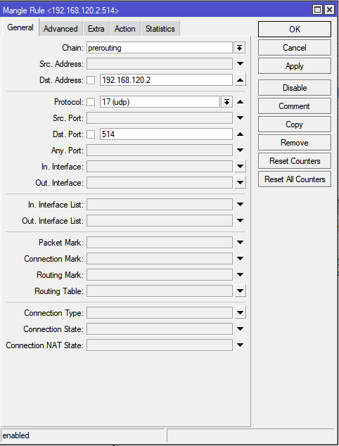

I assumed that I could MANGLE the outgoing log traffic and force it into the L2TP interface.
I have tried endless combinations of Src & Dst; Out. Interface list; etc. and get no mangle traffic.
Even if I just mangle all traffic on the router (192.168.88.0/24) it will start using the L2TP for all traffic on the router… but the logs still don’t populate.
Any incite or ideas would be greatly appreciated.
Thank you for your time.
Wrong chain, you need to use “output” (router’s own traffic) instead of “prerouting” (traffic from other devices).
