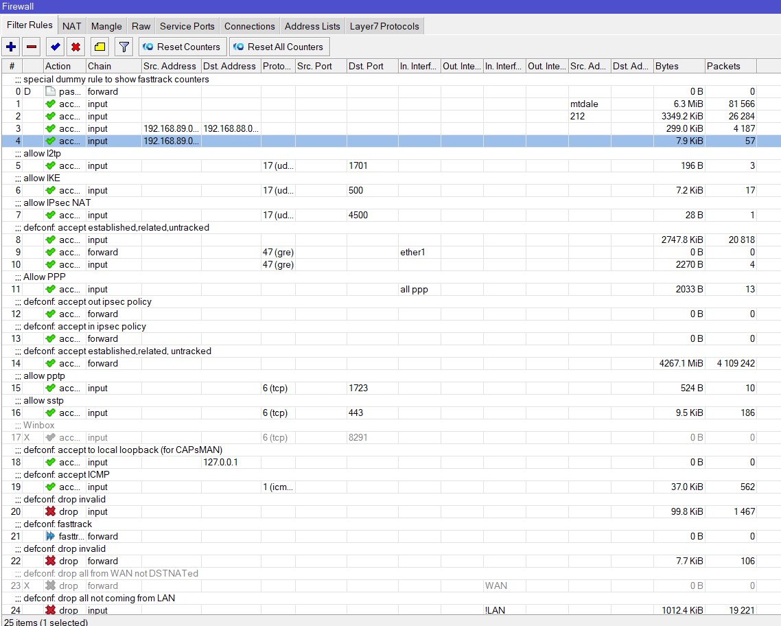

EDIT: I have confirmed that if disable the firewall rule that blocks all non-LAN incoming connections, the VPN works and I can access the router from either the 192.168.88.1 address or the public address. If I enable the rule, I cannot access the router at either IP address (even though the VPN still connects).

Lets look at the logic.
On the input chain (to the router), for services such as DNS, NTP etc, and to configure the router, the default rule is often in the form of.
add action=drop chain=input in-interface-list=!LAN
Since your VPN is not cinluded in the in-interface-list it is being blocked from accessing the router.
So simply add a rule above the drop all not LAN rule ( order is important! ) and it would look like
To access the router for config purposes:
add action=accept chain=input chain src-address=VPNaddress { where VPNaddress is the random Ip address you assigned to the VPN. }
To access the LAN subnets
add action=accept chain=forward chain src-address=VPNaddress dst-address=192.168.88.0/24 { where VPNaddress is the random Ip address you assigned to the VPN. }

Wow!
You made that so clear – thank you so much.

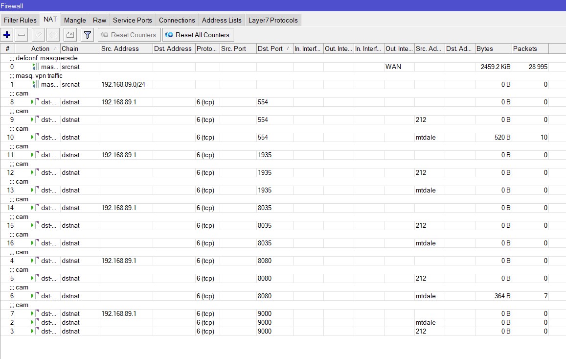

Just wanted to thank you again. I’ve been working on this and got it to a nice place (for now) where I am able to access everything from 2 locations that I am frequently at, as well as by VPN, with NAT (forwarding) for the camera.
