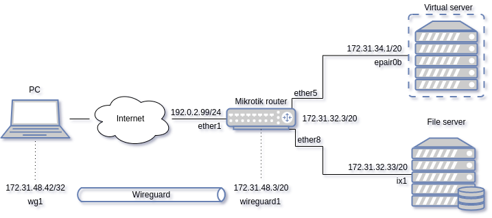

Firstly, a network diagram:

You can see visual representation of new subnets on this link. In particular it is network 172.31.32.0/19 (172.31.32.1 - 172.31.63.254) where:
  • 172.31.32.0/20 (172.31.32.1 - 172.31.47.254) is LAN network - in the config commented as “newconf”
  • 172.31.48.0/20 (172.31.48.1 - 172.31.63.254) is Wireguard network - in the config commented as “wireguard”
PC is Linux machine configured through Network Manager. I believe relevant sections of config file follows:

endpoint=192.0.2.99:51003
allowed-ips=172.31.48.0/20;
[ipv4]
address1=172.31.48.42/32
method=manual
I have tried various combinations of allowed-ips without much luck. I have also tried to replace this host by a client running on Android phone.
Virtual server is jail running on FreeNAS. Also instead of it I’ve tried to reach out physical Linux machine without luck.
Once I establish a wireguard tunel, I’m able to reach out to router’s and file server’s wireguard addresses. What I’m not able to reach out is the virtual server, which has only LAN address.

Anyway, without examining all details, it’s pretty clear, why you can’t reach 172.31.34.1 from client, when it has allowed-ips=172.31.48.0/20. It’s not in that subnet.
What you probably want is:
  • both servers with /20 mask (and same goes for all other devices in LAN)
  • allowed-ips=172.31.32.0/20 or allowed-ips=172.31.32.0/19 on client
  • no WG client on file server (at least I don’t see what it’s good for), you can simply access it using 172.31.32.33

Thanks, it works!
Since I needed to access that server somehow remotely, I did so. I can remove that one now.
Just to recap how it looks now:
On Mikrotik I changed from:
/ip dhcp-server network add address=172.31.32.0/20 comment=newconf dns-server=172.31.32.3 domain=m9.scrool.net gateway=172.31.32.3 netmask=19
to
/ip dhcp-server network add address=172.31.32.0/20 comment=newconf dns-server=172.31.32.3 domain=m9.scrool.net gateway=172.31.32.3 netmask=20
And on PC (client) side from:
to
(so I can reach out also devices in Wireguard network).
